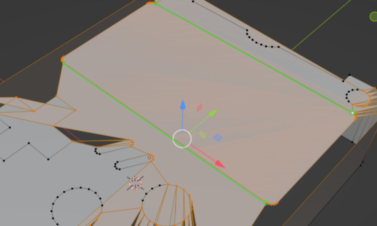

The problem is because you are using Vertex Select Mode, some Edges (and Faces) that you don’t want Selected, are also Selected, for instance:
You need to make your Selection in Edge Select Mode. Then try again.
