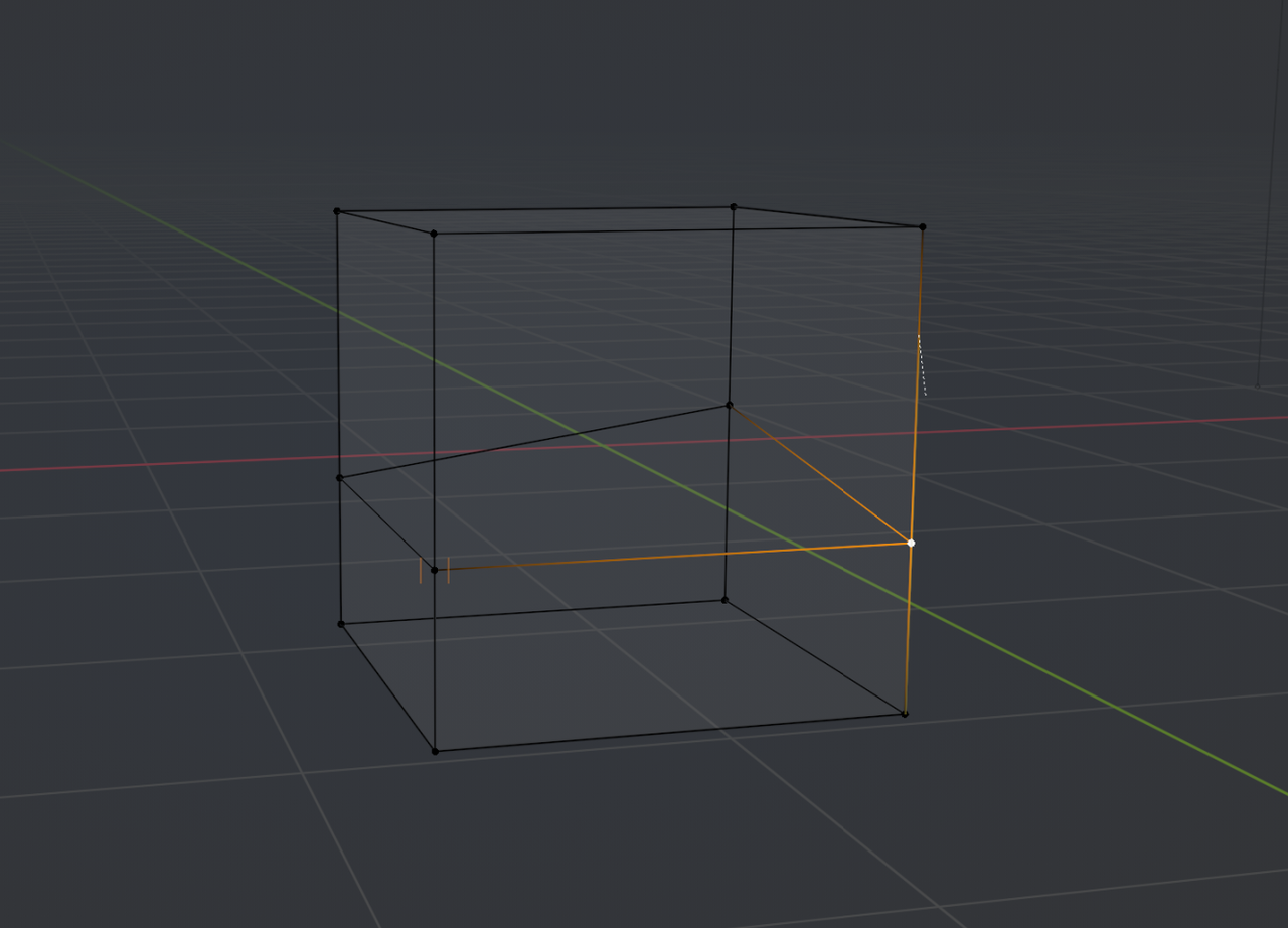

    Simple example; set the Snapping to Vertex (I would not enable the magnet icon) and Select the Vertex you want to Slide and hover the Mouse near the Vertex you want to Snap to (so it needs to move in the wanted Slide direction):

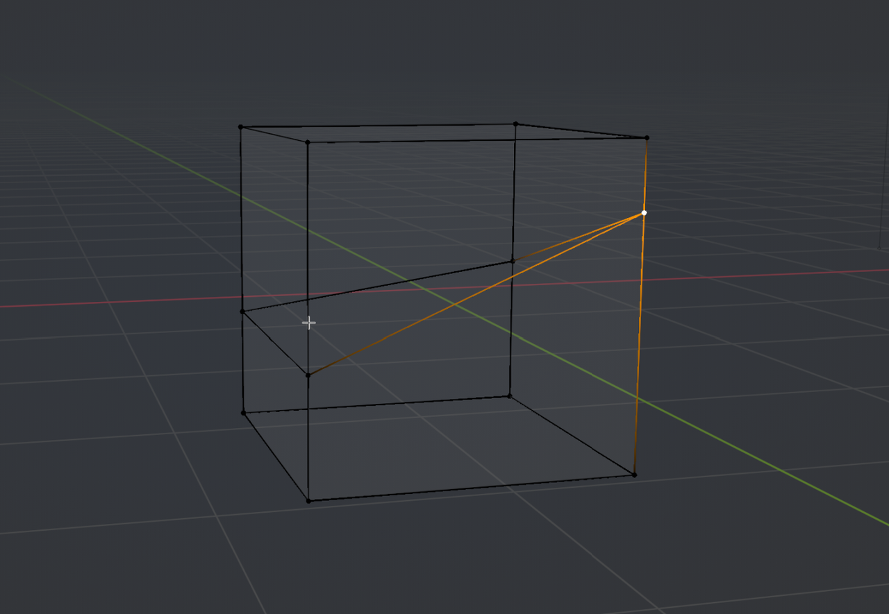

    Pres G, G and move the mouse Pointer to the Snap Vertex and hold CTRL:
    In more complicated Slide situations, like yours, this doesn’t work very well and you’ll probably need to move the Mouse Pointer tiny bits to get the ‘blue Vertex’ to Snap correctly…
