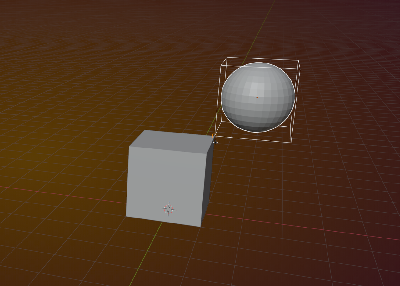

    In Object Mode, the Bounding Box of the Sphere is used to Snap with, so Snap Base set to Closest, gives something like this:

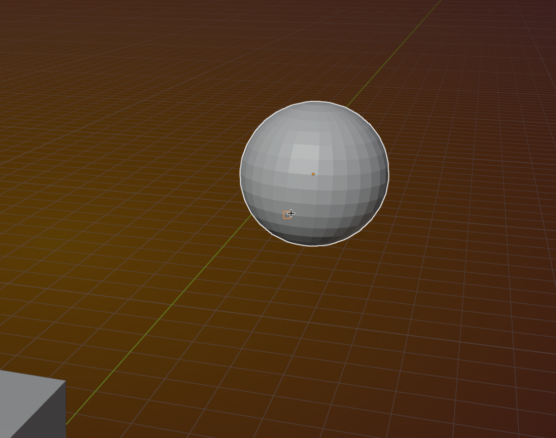

    To do this (and it might take some practice), G to Move the Sphere, then B, to set the Snap Base (choose a Vertex on the Sphere):

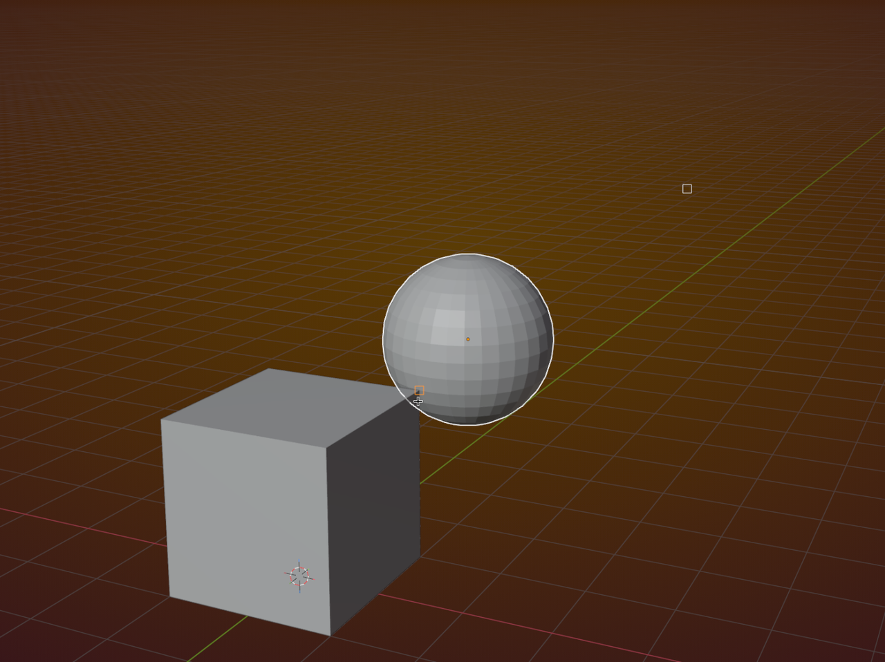

    Then Left-Click (or ENTER) to confirm and Snap by moving your Mouse Pointer to the Vertex you want to Snap to:
    Like I said, it takes some practice, but it is super handy and takes Blender’s Snapping to a whole new level.
