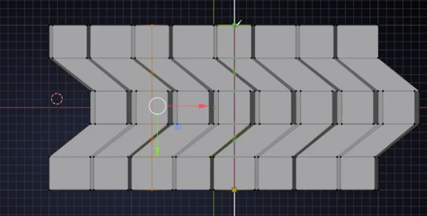

    That is because your mesh isn’t ‘straight’ at the ends.
    Like in this example:
    The Simple Deform considers the ‘farthest away points’ and bends those 360° (your extremes ‘meet’.)
    That is why I use the Knife tool to cut it straight.
    From this video:
    https://www.youtube.com/watch?v=-4eKbpt_ZtM&t=654s
