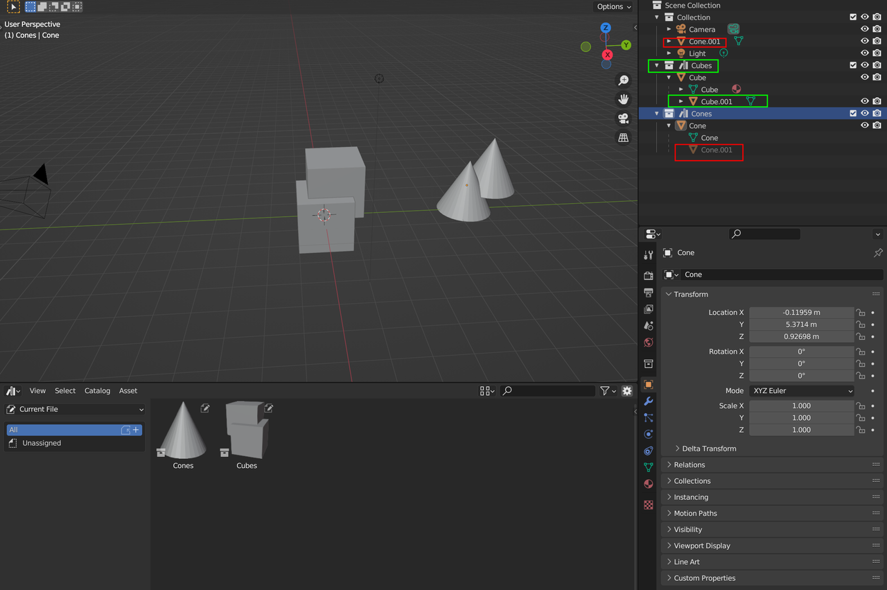

Hi @Swissmountain ,
If there is a Parenting Relation between the Branches and Trunk, you’ll need to put both in a Collection, not just the Parent (otherwise the Child will only be ‘Linked’ in the Collection and not be Marked as Asset):
