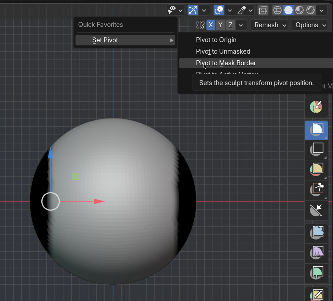

     I can’t remember exactly what Kent did, but what should work, is:
    with X Symmetry enabled: A > Smooth Mask (as mentioned above by L C) and then Set Pivot to Mask Border:

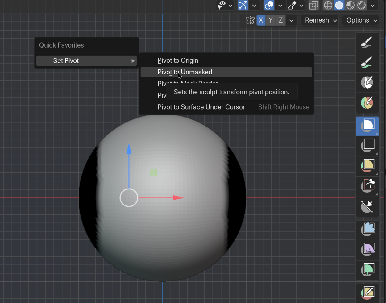

    Set Pivot to Unmasked gives this:
    Without the X Mirror, the Pivot will be in the Center of the sphere in both cases.
