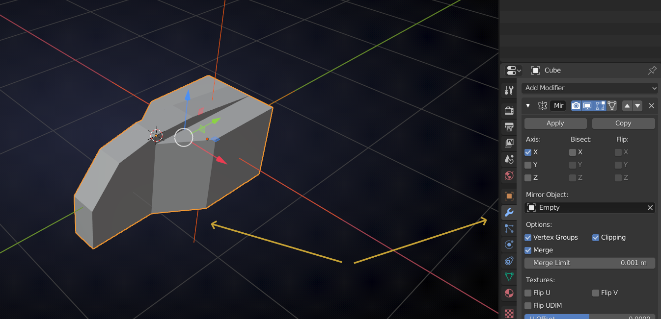

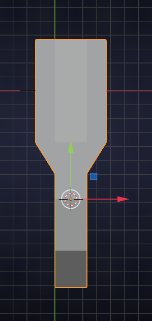

    The mesh has shifted, so the Origin is again at the center of the Object, but that is because of the mirror modifier.
    Look closely at your third screenshot; it’s got a ‘hole’ at the side!
    You could use an Empty or so as Mirror Object:
