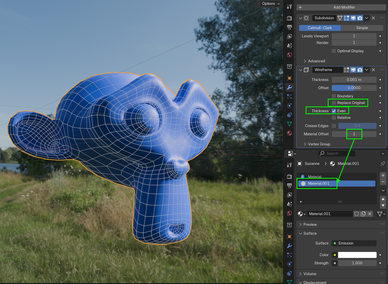

    Well, not really. What you can do, is Add a Wireframe Modifier with a different Material, something like this:

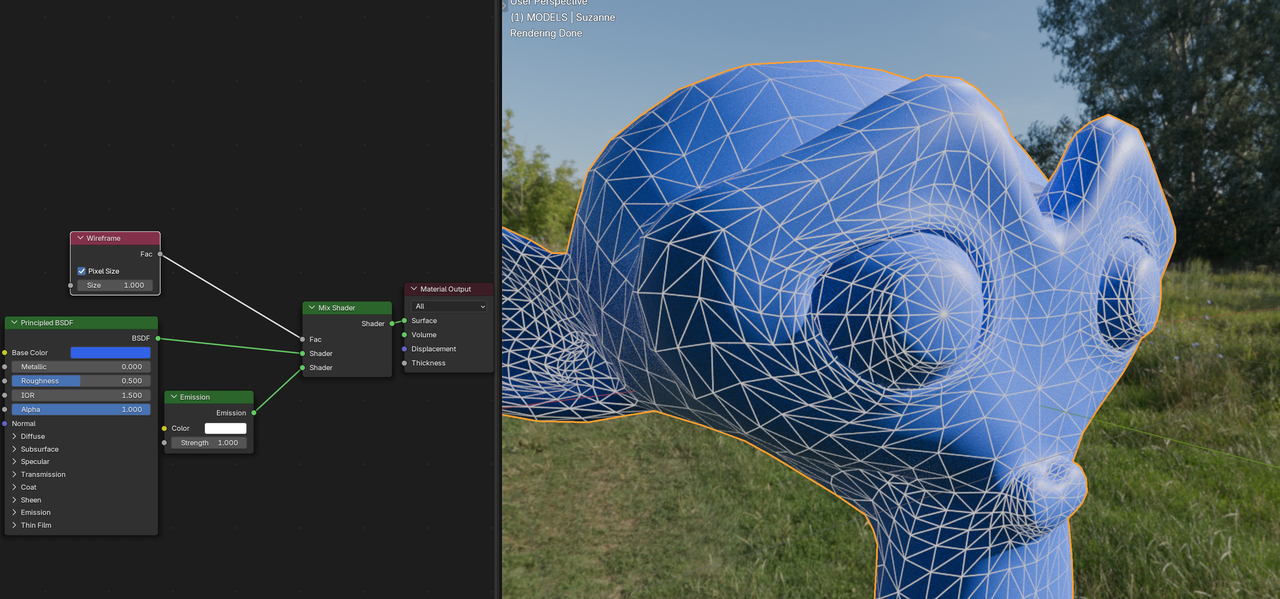

    And there is a Wireframe Node in the Shader Editor, but that gives the Triangulated Wireframe:
    Which is probably rarely what you’d want.
