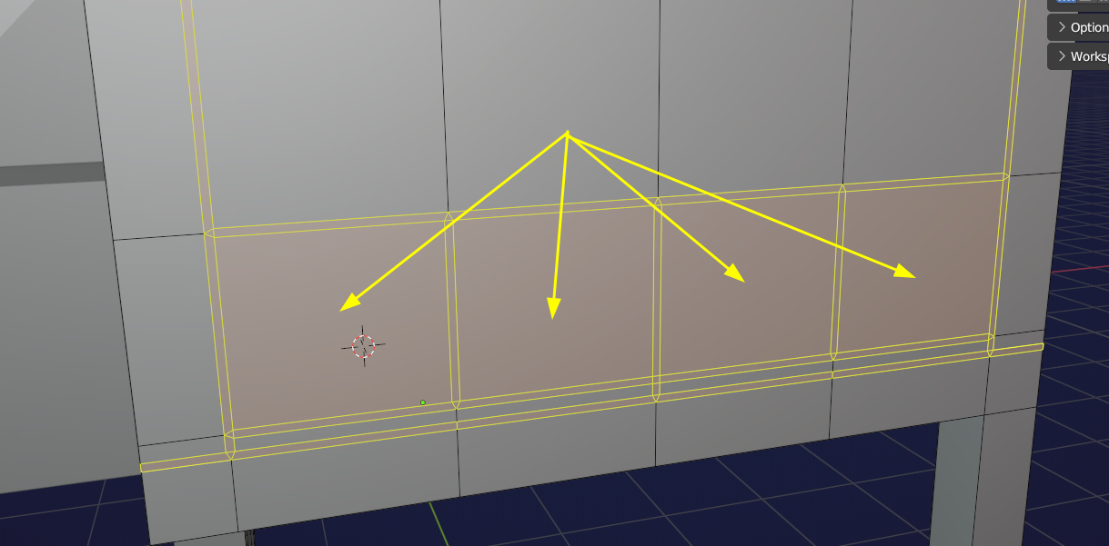

    Right Roxana,
    I see what you mean, I think.
    After Beveling, these Faces:
    each have 4 Edges around them selected and are therefore also selected. This is how it should be.
    The fact that this didn’t happen in the video, was actually a ‘bug’ in the older Blender Versions.
    You’ll have to deselect them by hand (in Face Select Mode).
