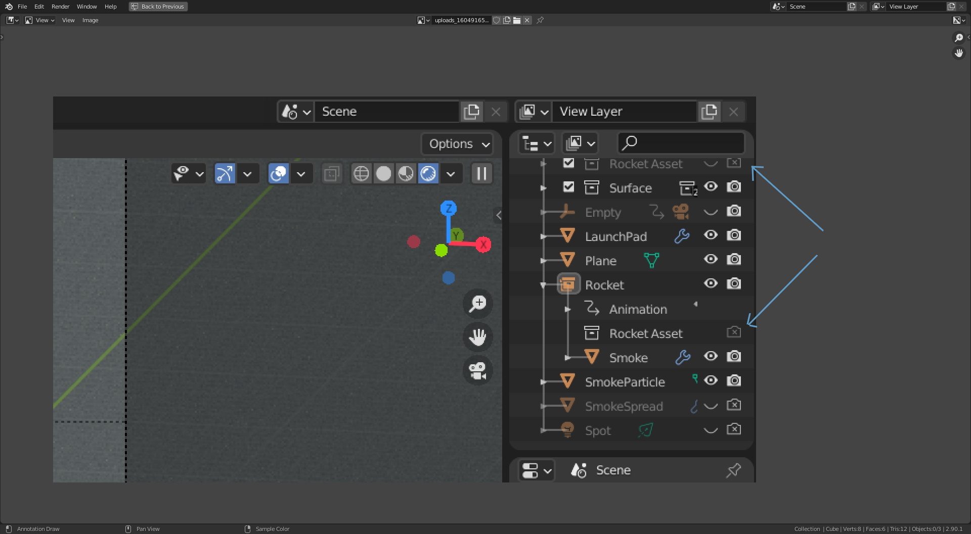

    Hey @almo1 ,
    I just looked at the image you posted in the previous question and you have the rocket asset disabled for renders.
    Turn it on and you should be good.
    Turn on either and both will be on.
    You have a spot light off also, if your using it turn that on. just leave the smoke spreader off and it will do it’s job but you wont see the actual spreader in the render.
