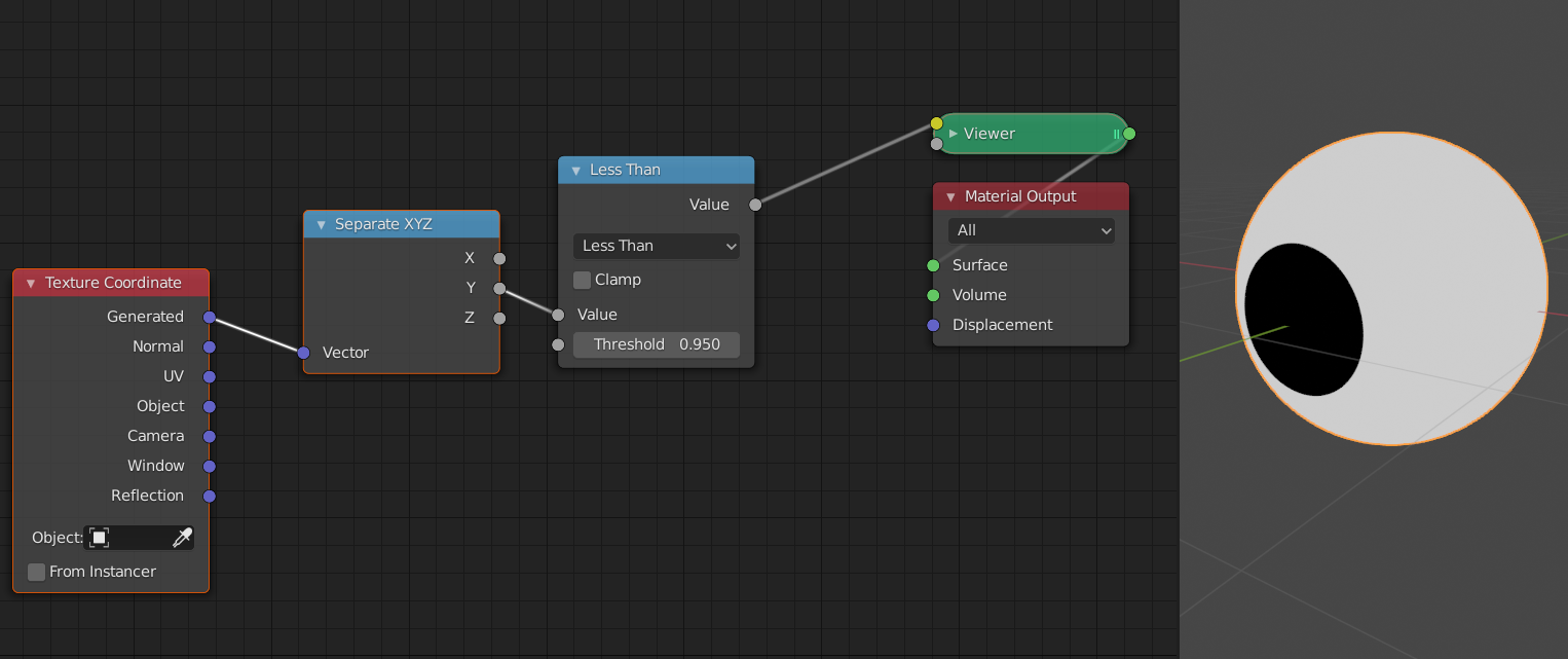

What you could also do, is to not use Object Coordinates, but Generated and also not use a Gradient Texture for the Pupil and Iris, but something like this:
But, like I said: you should be safe to do the rigging as you have it now (but I’m not a rigger, so don’t take my word for it…)
