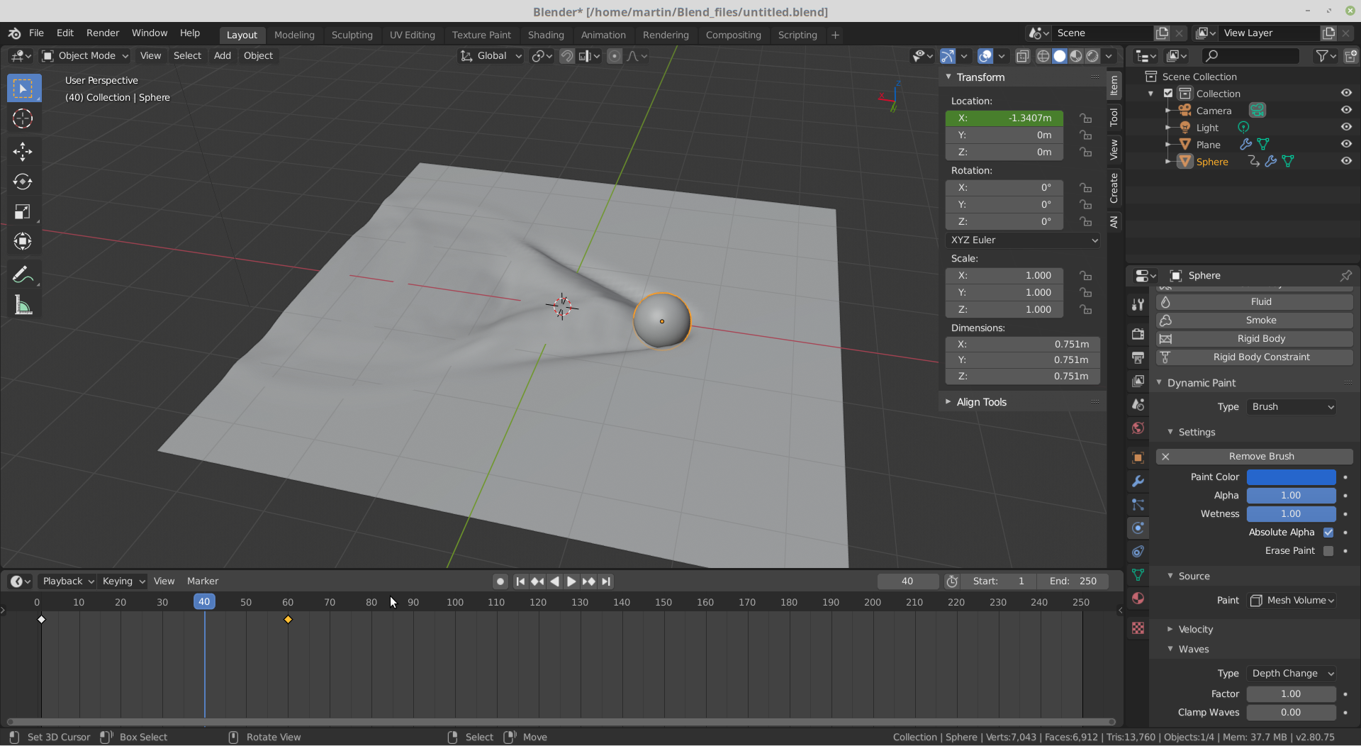

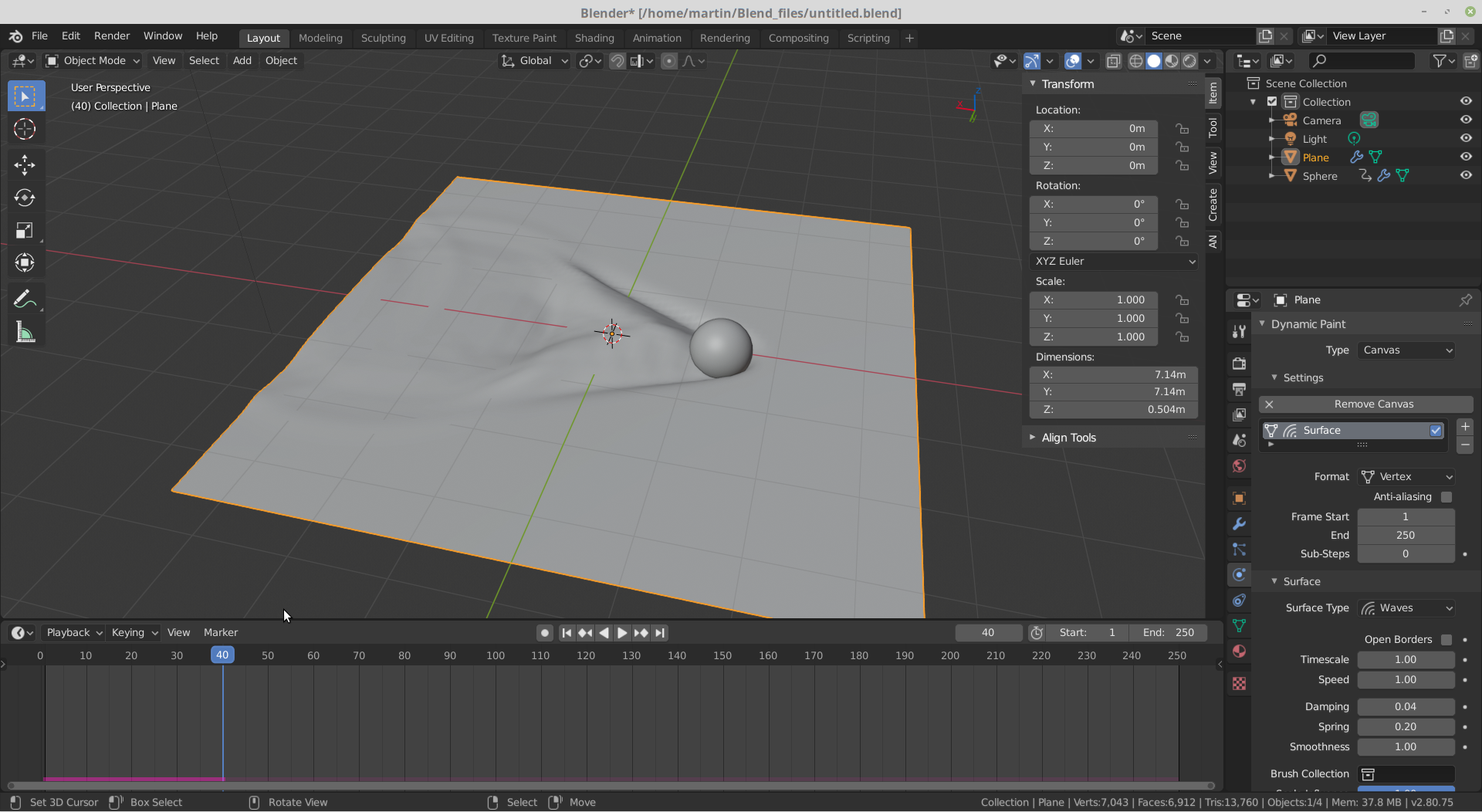

    What are your Dynamic Paint Settings? They should be something like this:
    For the Canvas and something like this:
    For the Brush.
    Make sure the Brush is moving.
    What do you mean with using the Wave Modifier?
    Setting the Surface Type of the Canvas to Waves?
