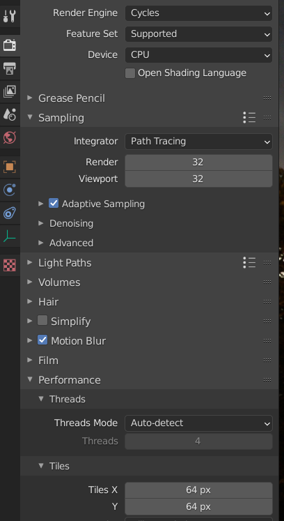

    Maybe it’s just your driver…is it up to date?
    You could also test rendering with Cycles on your CPU, see if that makes a difference change your settings to something like this:

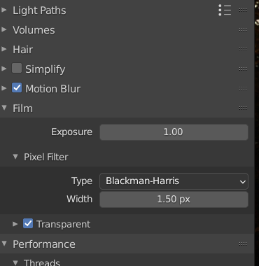

    Or even better (read: faster), do not render your Ground Plane at all and set the Film to Transparent:
    Then you can later add the Background in Compositing (we can walk you through how to do that. It’s not difficult.), can’t have background flickering if there is no background, right?
    Still a good idea to try it with Ground Plane for a few frames at least to see if your GPU is causing this somehow…
