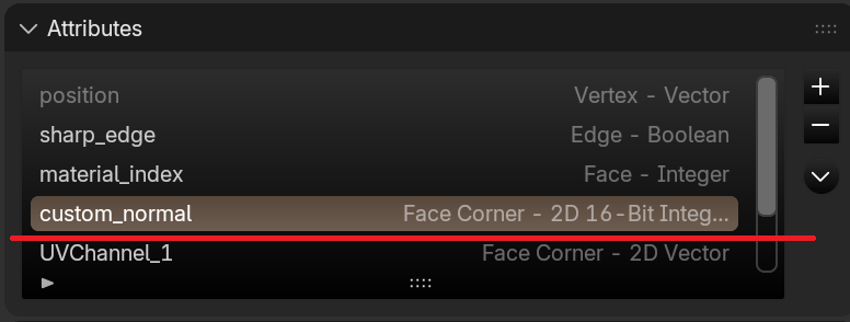

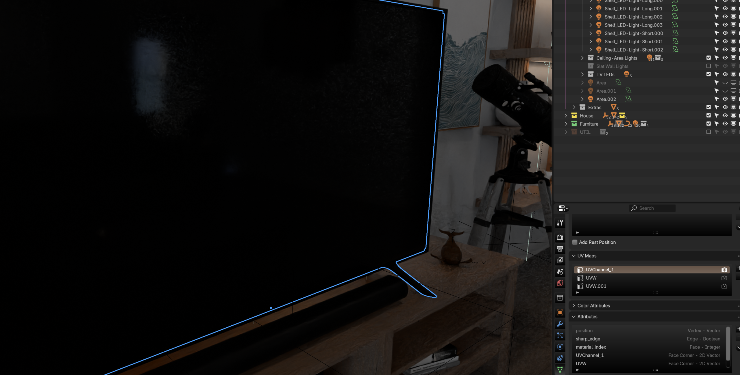

Sorry for being late to the party.There’s a custom normal attribute on the model. If you delete that, the reflections work fine. I assume that’s from whatever program this model was made with.And yes, the model is questionable.
