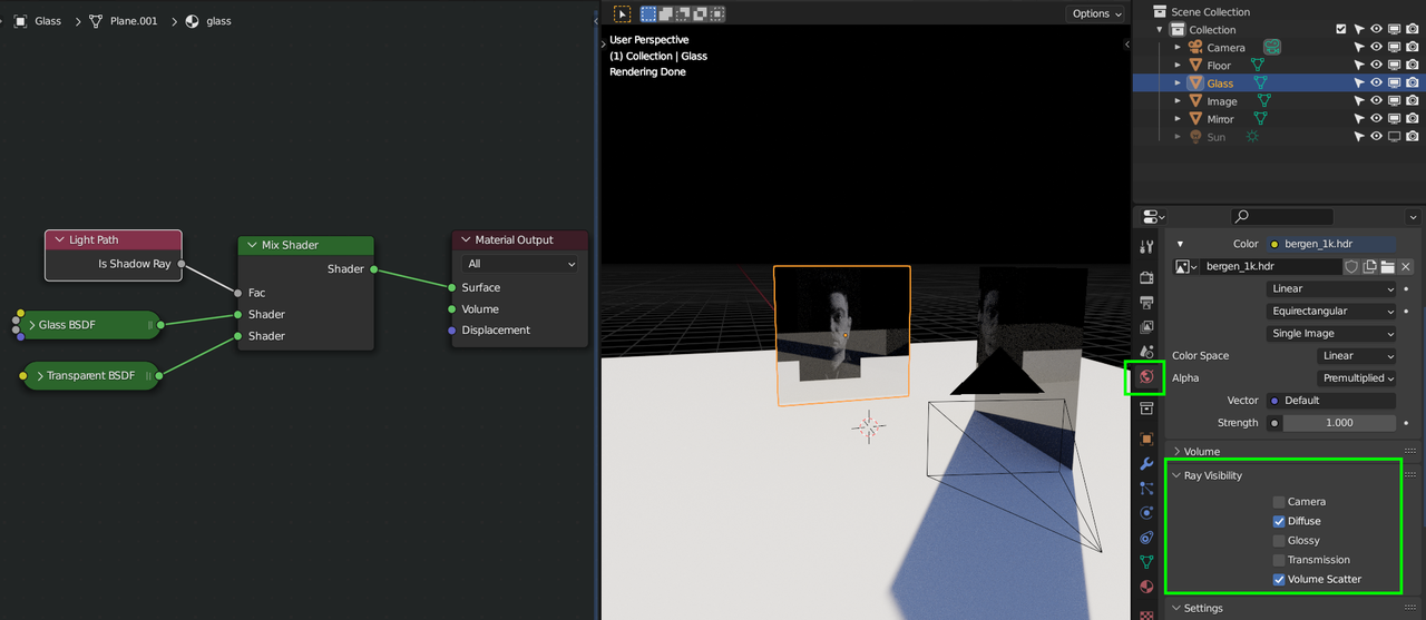

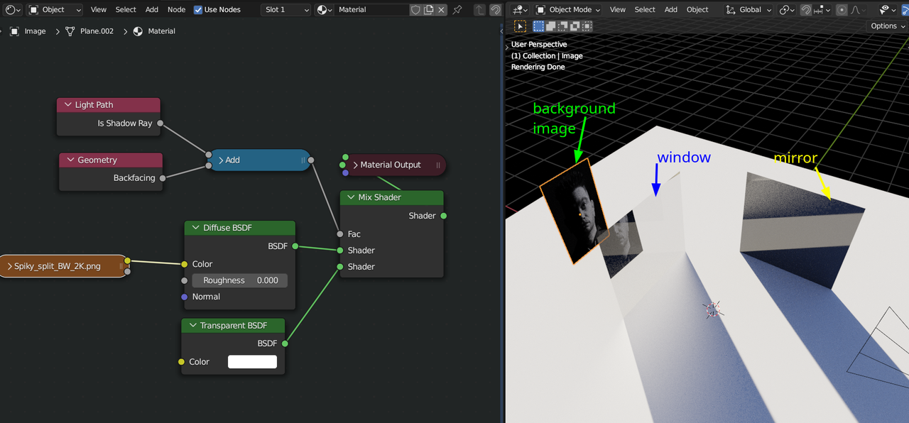

    For instance, you can use this Node setup for the BG Image:
    You can of course also use an Emission Shader, in stead of a Diffuse for the BG Image…
    Looking through the Camera, with these World Settings (I removed the window’s shadow here):
    I turned off the World Glossy, so it won’t reflect in the mirror, but that will probably not be necessary for you, if your BG Image covers the whole window…
