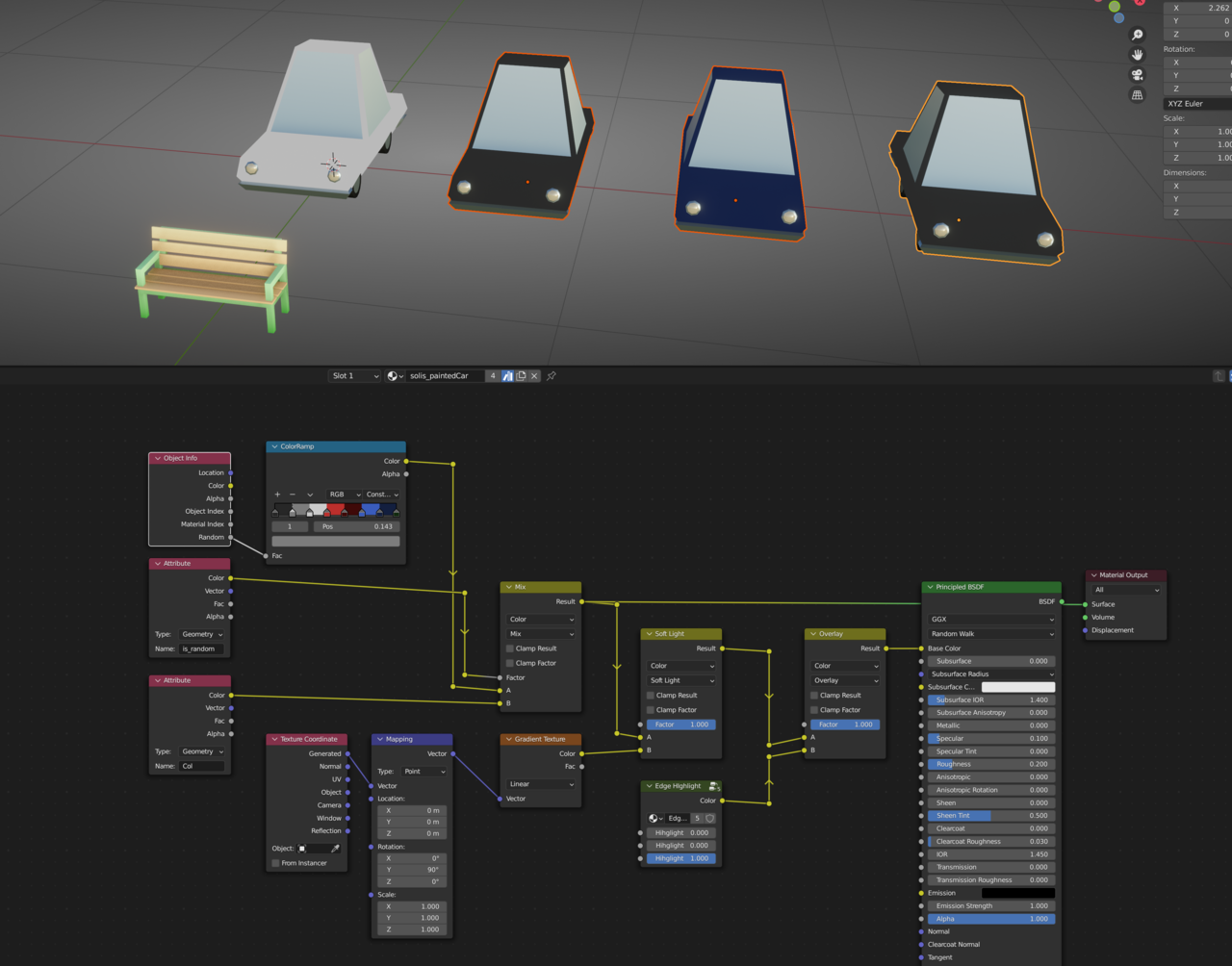

    Dwayne Savage, Thank you!  I was thinking that “Random” out of “Object Info” was returning either a “0” or a “1”, but it does seem to return float rather than integer. I removed the two math nodes and it fixed it! I was trying to do some crazy math that wasn’t working in my own mind which complicated everything. Just removing those two math nodes fixed it!  And also, Thank you Martin Bergwerf for helping me think more about the mix node. It works by putting the color ramp into input “A”, the “is_random” into “Factor” and “Col” in input “B”. I’ll put the blend file up for anyone interested.
    https://mega.nz/file/5UxV0B7b#1ZsnPE-XBE3PdPPr3Bpgl2_U1lyMAkScfd3P_9MCiUE
