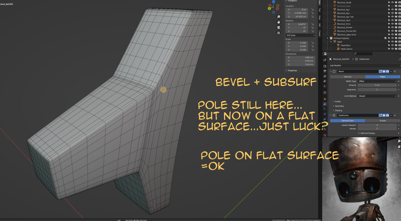

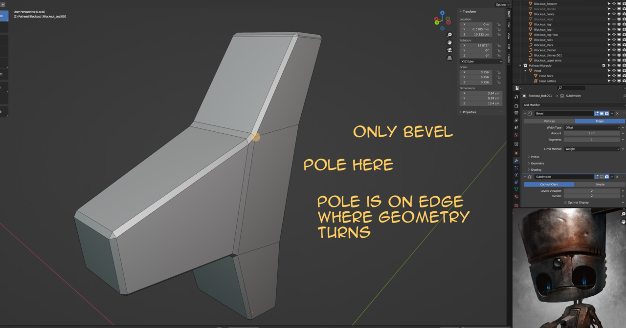

    I don´t think I have 2 small triangles in my second image, but indeed, the shading issues regarding Poles + Subsurf gets less noticeable when the faces are smaller (from what I saw so far)
    You said at the very beginning that Subsurf works as long as it is all quads, are Poles not bad for Subsurf then ? Since even after the bevel, the Pole still persists, but the shading issue on the Subsurf is gone (Image attached)
