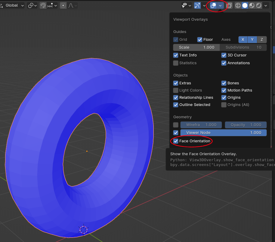

    Check your normals on the high and low tyre in Blender, one or the other could be the problem.
    All exterior faces should be blue, if you see any red, in edit mode press A to select everything then SHIFT+N to recalculate the normals.
    You will then need to save and re-export the model.
