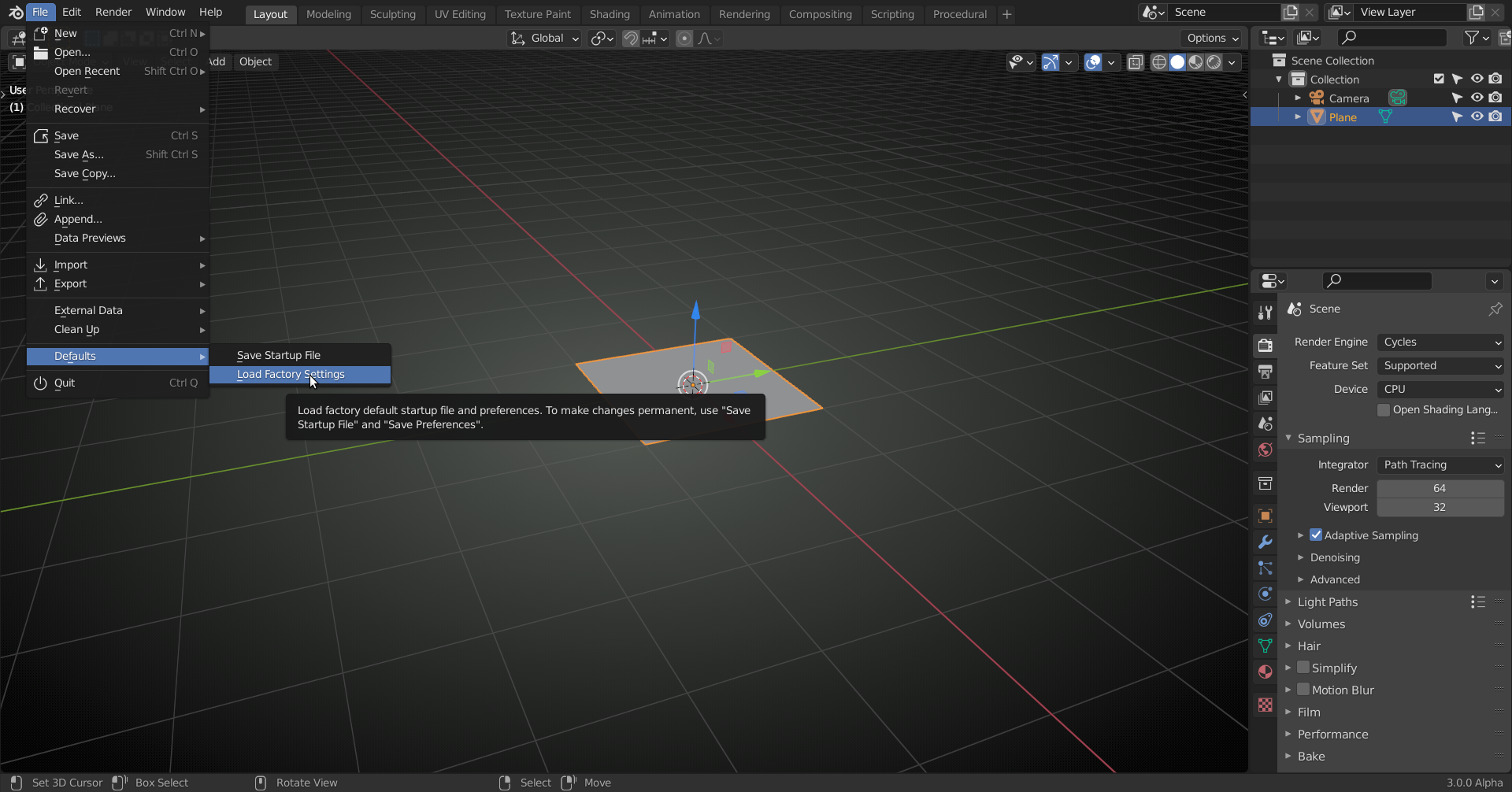

    Hi Florian, as far as I know, it is not possible (or at least unnecessary complicated and depending on your OS…) to have two different User Preferences for the same Blender version, but, what I would do, is have all your Addons and Settings as you like it and then, whenever you want to record a tutorial, just use the Factory Settings:
    That gives you a vanilla Blender and the next time you open Blender you have your usual version.
