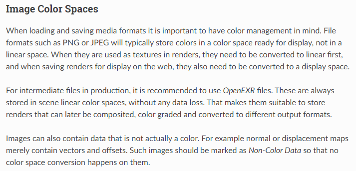

Yeah that Gamma correction is what the Shader is doing to the HEX value in order to give the same visually perception of the color that is directly being converted to over in the texture brush color.
It’s not what the texture paint brush is doing, it is directly converting the HEX into RGB without any
Blender Color Management: https://docs.blender.org/manual/en/latest/render/color_management.html
From the manual: Image Color Space seems to communicate what the Texture brush is working with I think.
