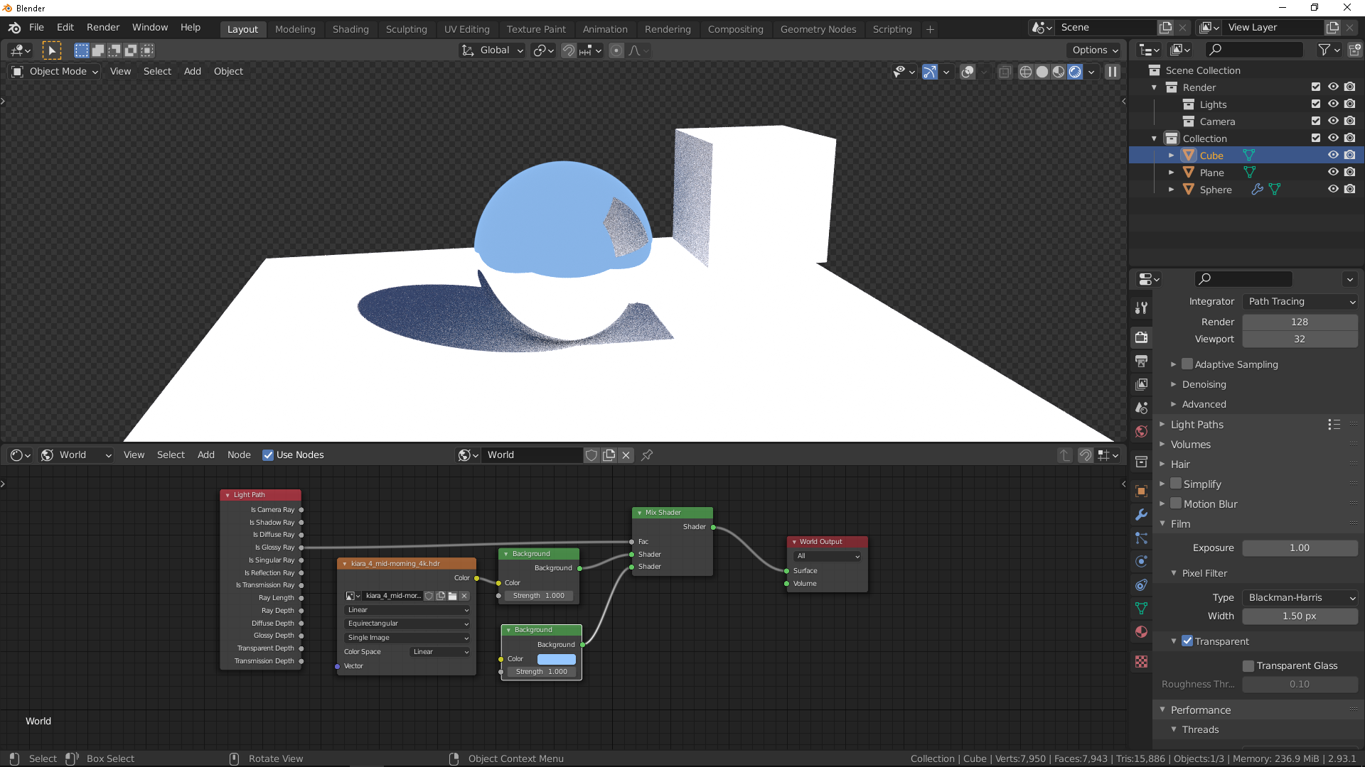

    Hey @sefiriya , yes you can.
    I have set up this simple scene with a UV Sphere with a basic metallic shader, a cube and a plane.
    If you use the Is Glossy Ray, this will use the HDRI to light the scene, but use the other background color for the reflections.
    As you see, you still get reflection from other objects.
