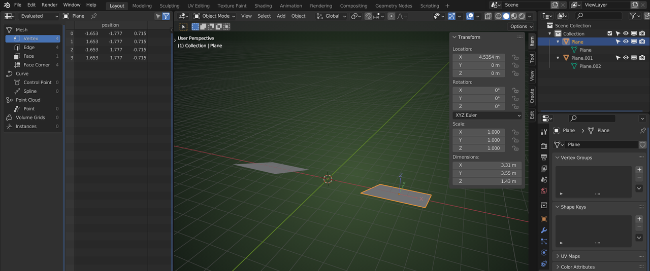

    Some images; here the two Planes have linked Data:

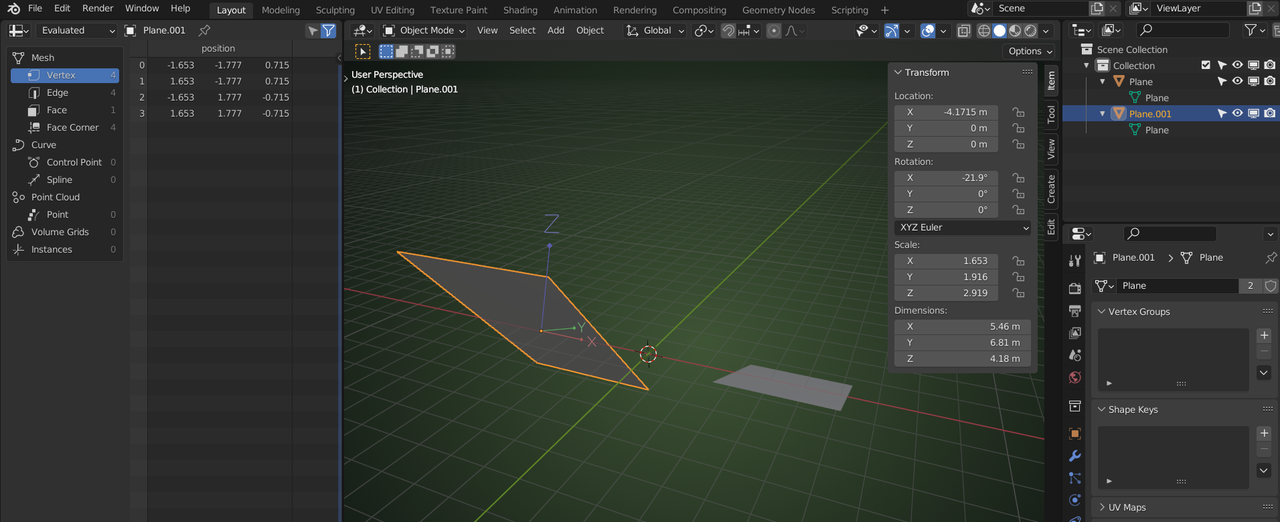

    Now, after un-linking them, the view right Plane has Rotation and Scale Applied (still looks the same, but the Vertex Positions are different):

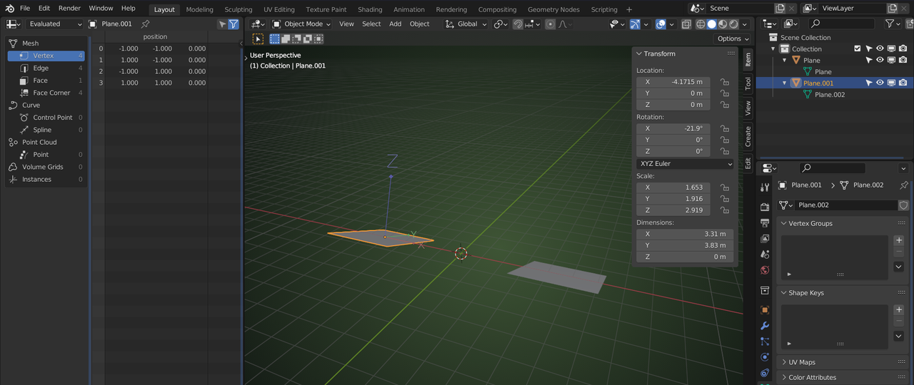

    Now look at the view left Plane (Rotation, Scale, Vertex Positions), while it is still un-linked:

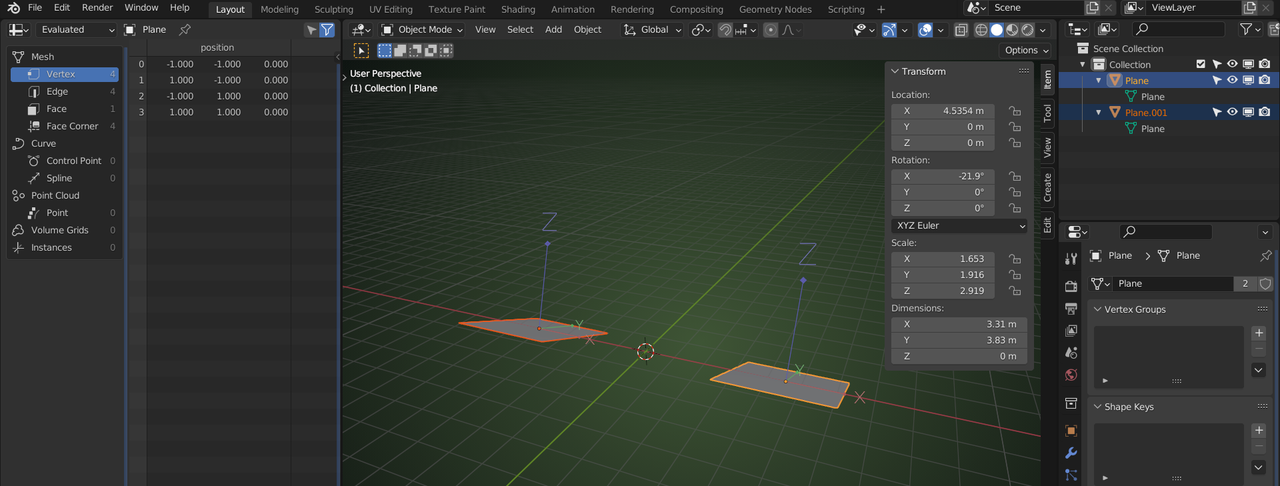

    And here after linking (the Vertex Positions are now the same as the view left Plane):
    You can see (I hope) that the Rotation and Scale shouldn’t be Applied now, but reset.
