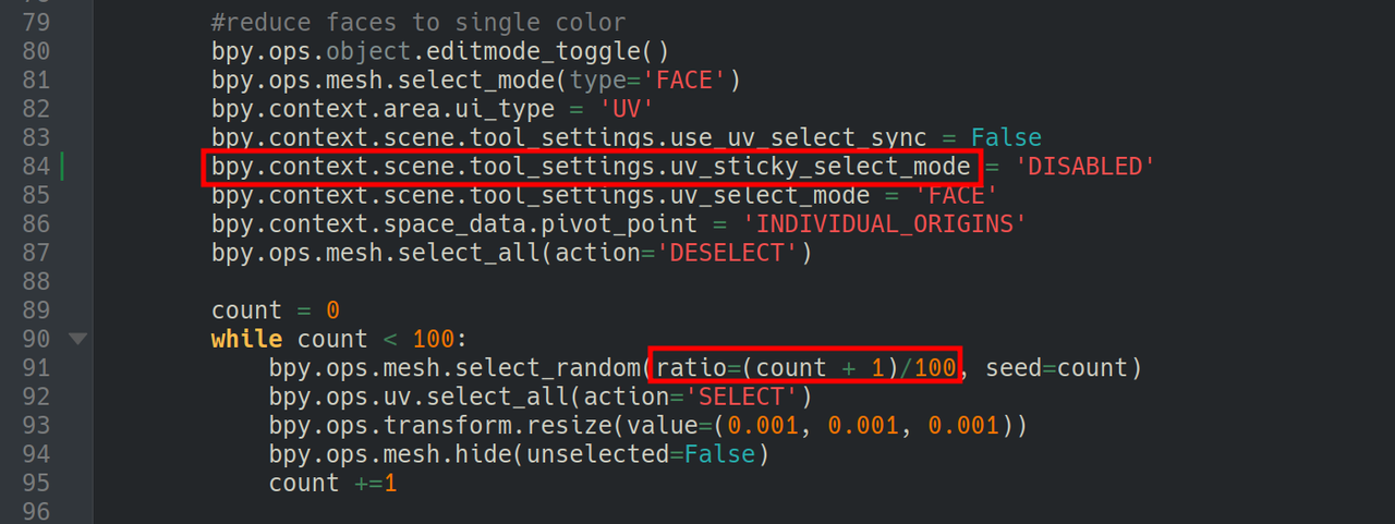

    Hi Kookie @bravecookie7 ,
    There are two things changed since the original script was made. If you change these two lines, it should work:
    Or you can use the Python script with these changes already made:
    https://drive.google.com/file/d/1sJZbAgtHfL1-hkgNPsTfWTJosOVtMawZ/view?usp=sharing
    Remove the old addon first, before installing this version.
