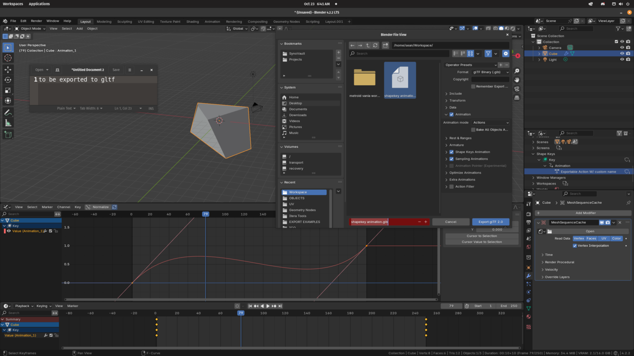

    GLTF stores attributes like vertex groups/weights for your bone names, empties with the bone names acting as translation points and actions storing translation data. most people use above portion for characters but for motion graphics which im guessing this is about i would be looking at shape keys. the animation data is heavier as its basically storing a position offset for each vertex of your mesh but it may just have to be.4-10-23 06-41-33.png

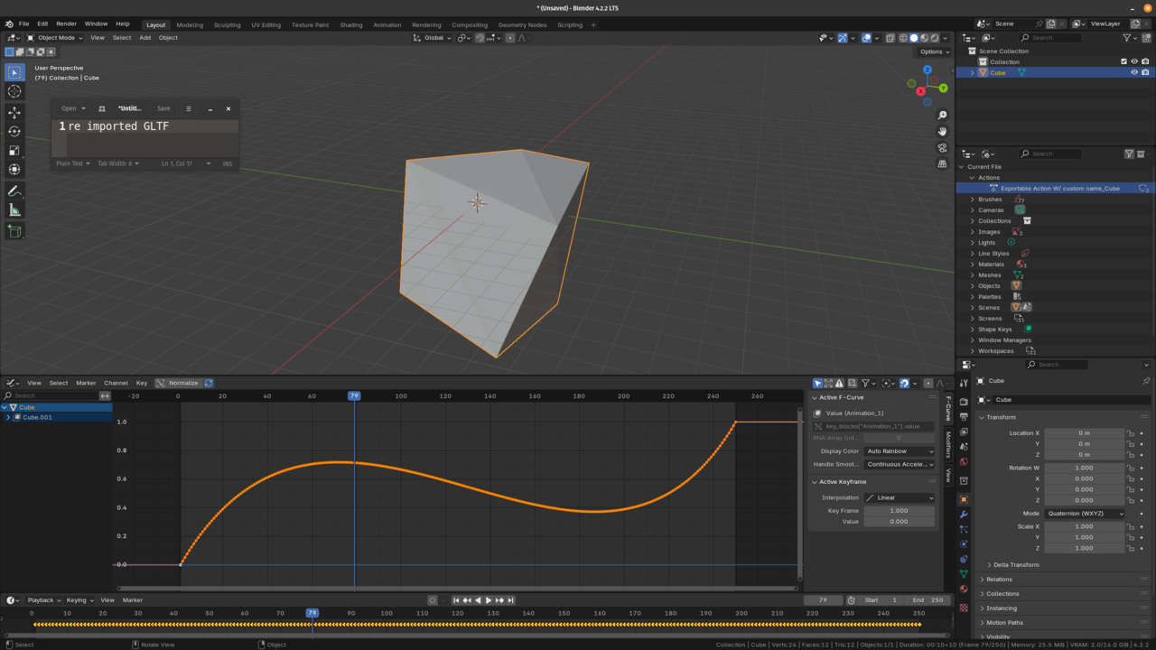

    i ran a test with what im pretty sure are default settings and after making a shape key and naming it in the “outliner->blend file” it imported fine with shape key baked. unless you change settings, whenever you export to a file that doesnt support the modifiers (basically everything) the modifiers are applied. you need to figure out how to bake your animation to work off of the normal bone and armature or as a shape key. I’ve also heard people using something called a mesh sequence which may just be another form of the shape key data but this is my understanding.
