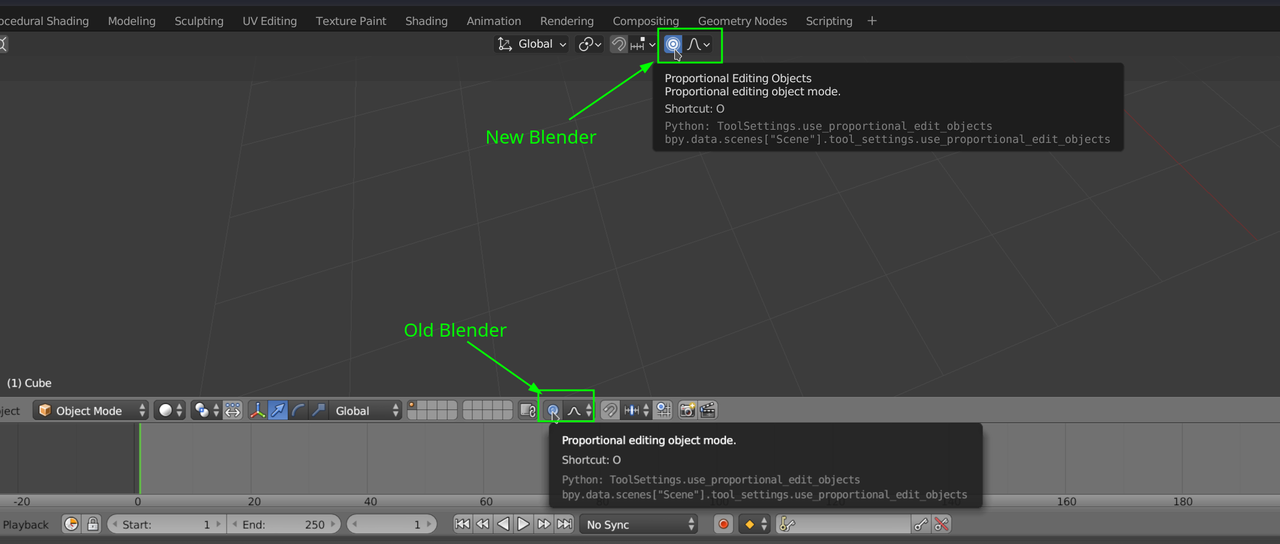

    Hi Yisrah @YAbrahaim ,
    Proportional Editing can be toggled on/off with the “O” Hotkey, or in the ‘Header’:
