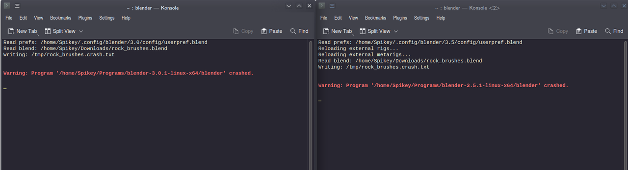

    Hm, weird…
    Your file crashes Blender immediately, when I try to open it in 3.0 and 3.5 (and 2.93):
    The crash.txt has no information in it, apart from the Blender version…
    I could open the file in 3.6 (and 4.0) and checked some of those Brush Textures and each one behaved completely normal/as expected.
    Check your drivers and also try  File > Defaults > Load Factory Settings (could it be an Addon misbehaving?)…
    Can’t think of anything else to try at the moment…
    Let us know how it goes, please.
