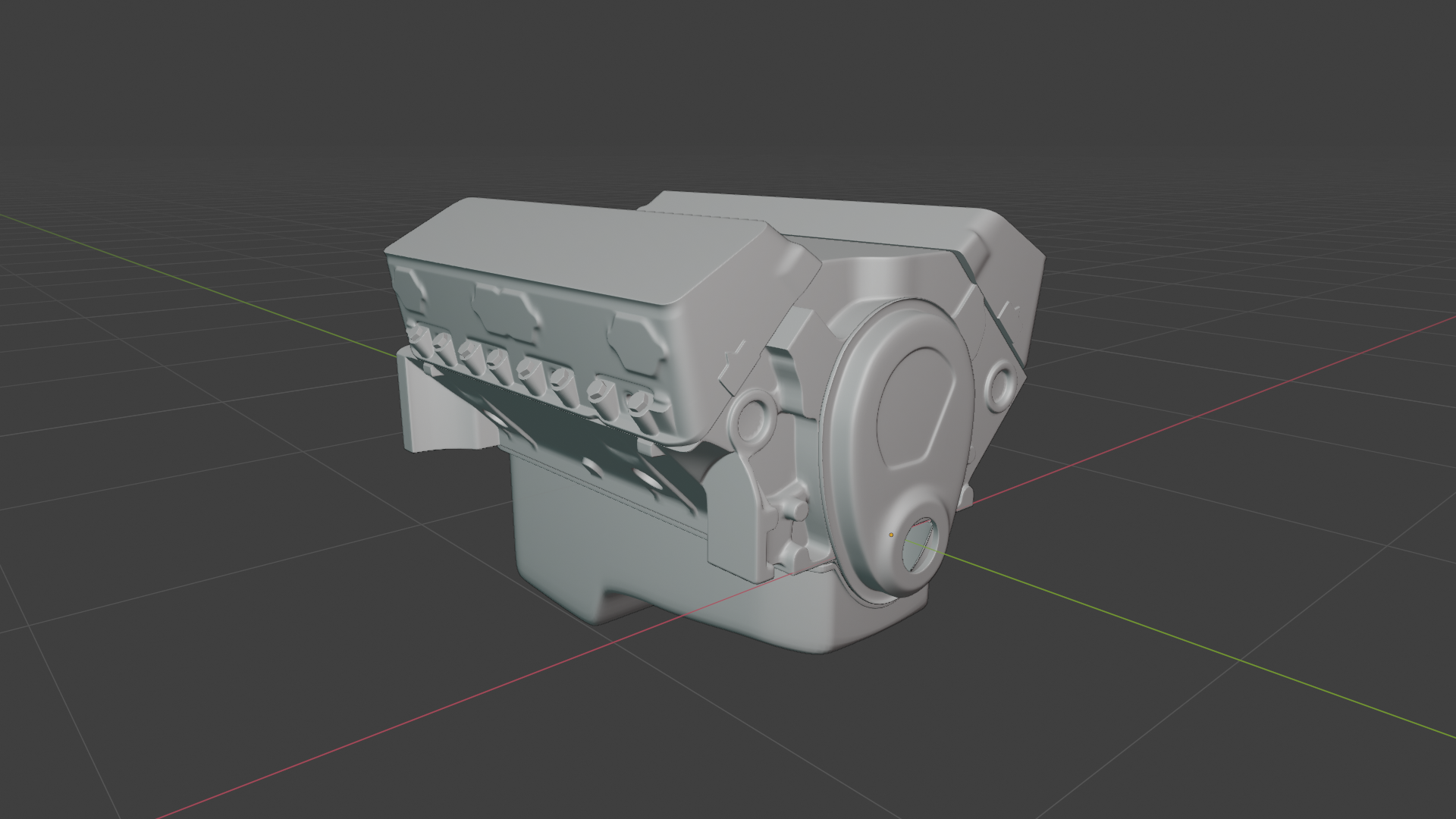

    So that was a fun little break, but – back to work!  This thing’s not going to model itself, you know.
    I’ve got the cylinder head finished out and duplicated – not mirrored; the two cylinder banks of the engine are offset slightly along the Y axis, so it was a matter of duplicating the head, rotating it around the engine’s Z axis, and then giving it a little nudge to get it exactly in place.  I am lucky at least that the cylinder head itself IS a duplicate – I mean, in “real life”, it is literally two of the exact same part-number.  So it’s not even cheating, to make a copy in this case. 😀  Linked-duplicate, of course, so any future edits will apply to both.
    Also did the timing chain cover, most of the oil pan, and gaskets for all of these.  It’s kind of funny – compared to the rest of the engine components the oil pan is almost jarringly plain and lacking in interest; but that’s really just how they are, unfortunately.  At least on the other side there’s a drain bolt (that I still have to put in) to break up the bland.
    The next components up after the oil pan are the water pump, which mounts kind of across the front of the timing cover, and the fuel pump, which mounts to that sorta house-shaped flange on the near corner of the engine block.  The fuel pump on this engine is mechanical, operated by a pushrod from the camshaft.  If you look closely you can see the shape on the front of the engine behind that flange, angled slightly upward toward the middle of the block (where the camshaft would be), where the passage that would accommodate that pushrod is cast into the real thing.
