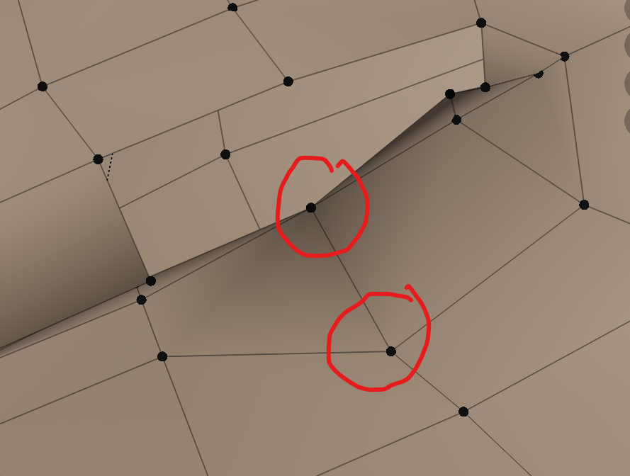

    You got sharp eyes/. 2 vertices in the lip ended up merging, they must have been too close together at one time and I didn’t see it.
    Also a vert just below it needed to be pulled up closer to the lip and it was also sunken in but you made a very good catch here..
    I unhid the part of the upper lip to show better what you correctly point out. I turn off the subd as well.
    The corner of the mouth needs to be pulled in a bit I think. I was trying to position it as best I could to suit the subd and then tweaking here and there I fouled things up a bit and missed somethings. I know the darker areas are shading issues but most of the time they are faces behind that need to be deleted or it’s something I can’t tell why there’s a n issue even after changing things here and there. I found occasionally merge by distance revolves issues but often still does not merge verts on top of another. I found that when extruding an edge and snapping the vert to the next vert where you want to continue the faces will not merge by distance so I don’t snap to the verts any more for that and just merge the verts manually. I try not to use the auto merge as that has gotten me in trouble forgetting to turn it off. lol. Enuff of my rambling…8^]
