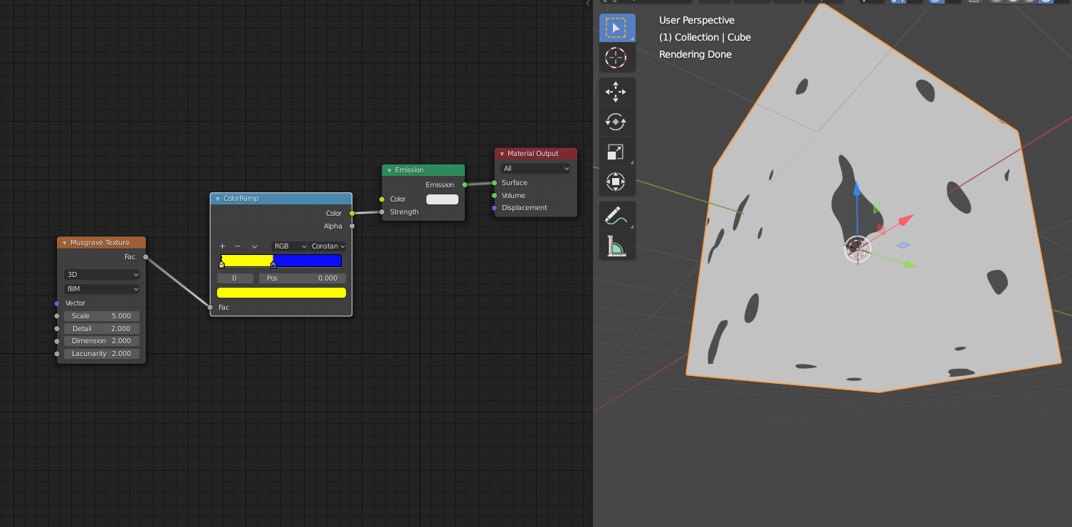

    Anyway; @duerer and @theluthier : in the video it doesn’t make a difference, while there are no colors used in the Colorramp 🙂
    Here’s an example with two colors that both have a Value of 1:
    Here’s what OSL uses for Luminance:
    As you can see, if R, G and B are all the same, it doesn’t do anything, but returning the value of R, G and B, or one of them, as they are all the same:)
