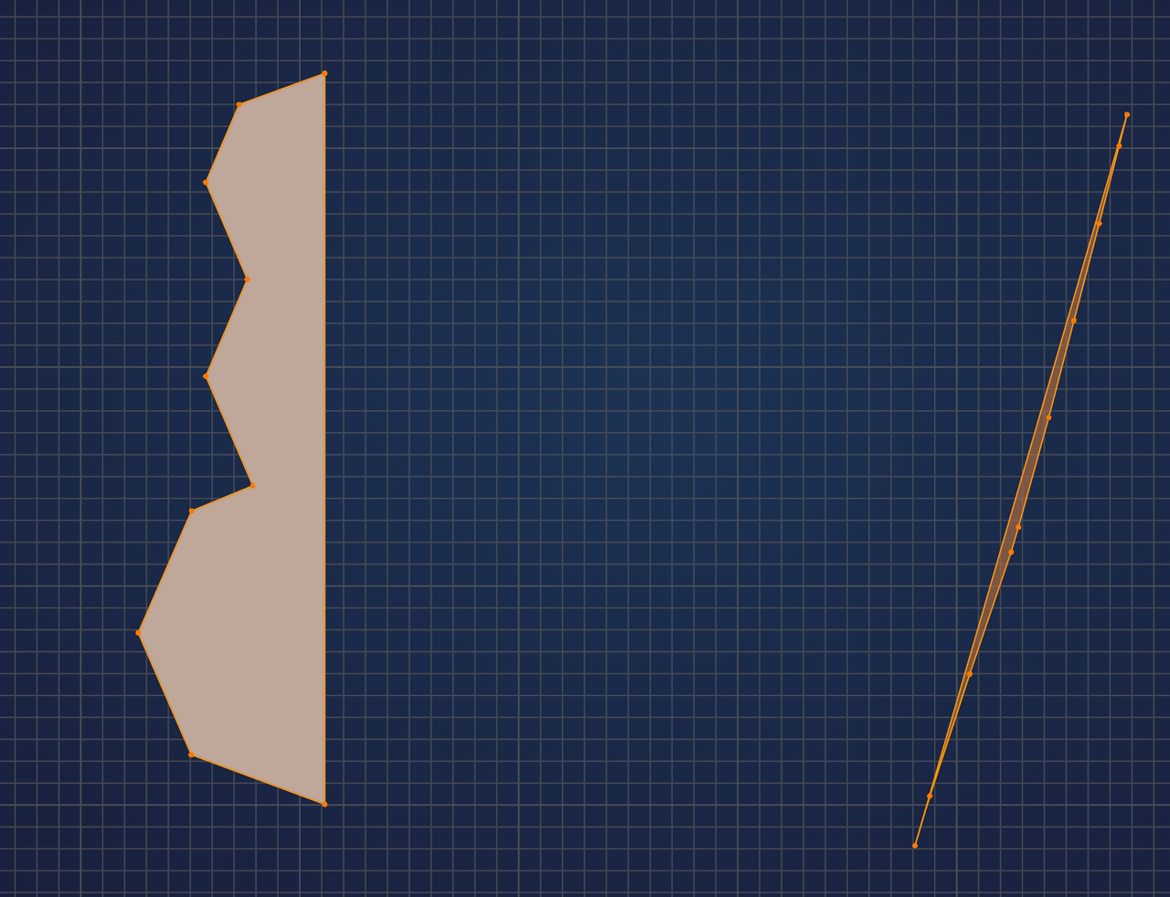

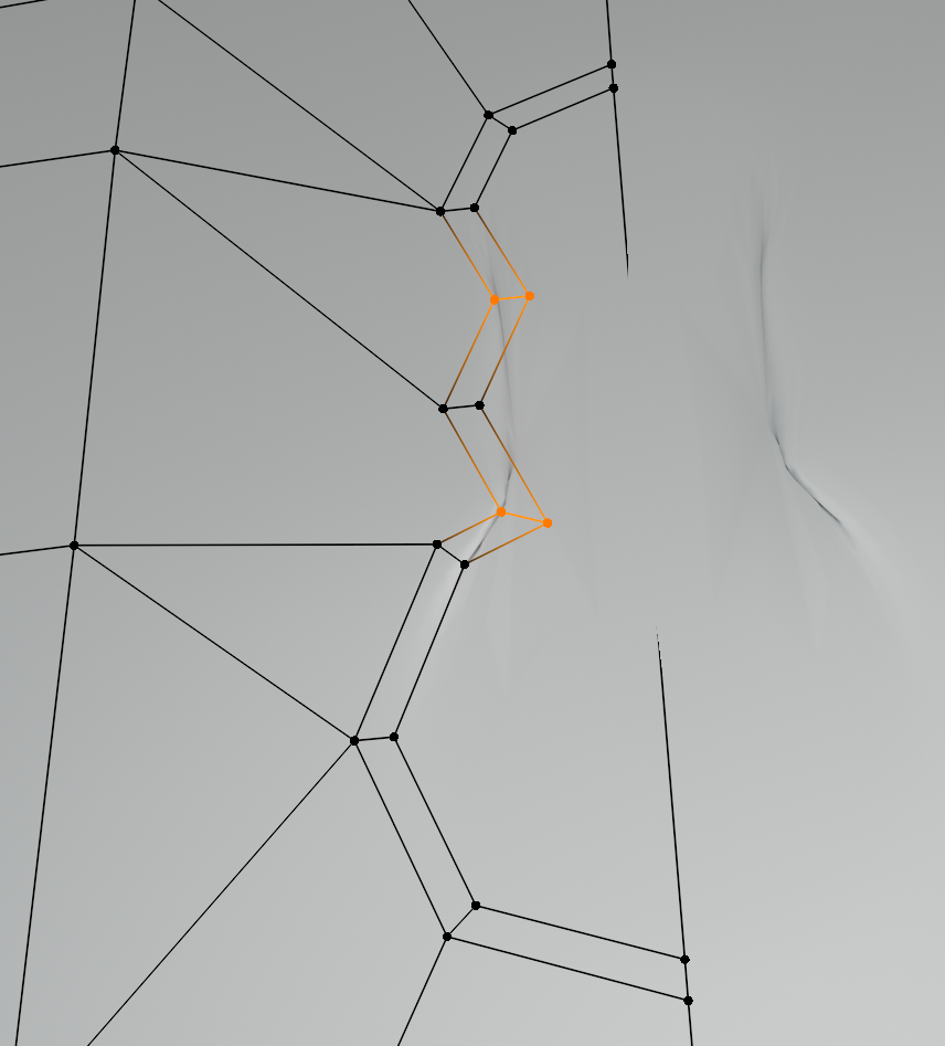

    These ‘pointy bits’ are causing most of the problems:
    Also, this Face is quite distorted (I Duplicated it for visuals):

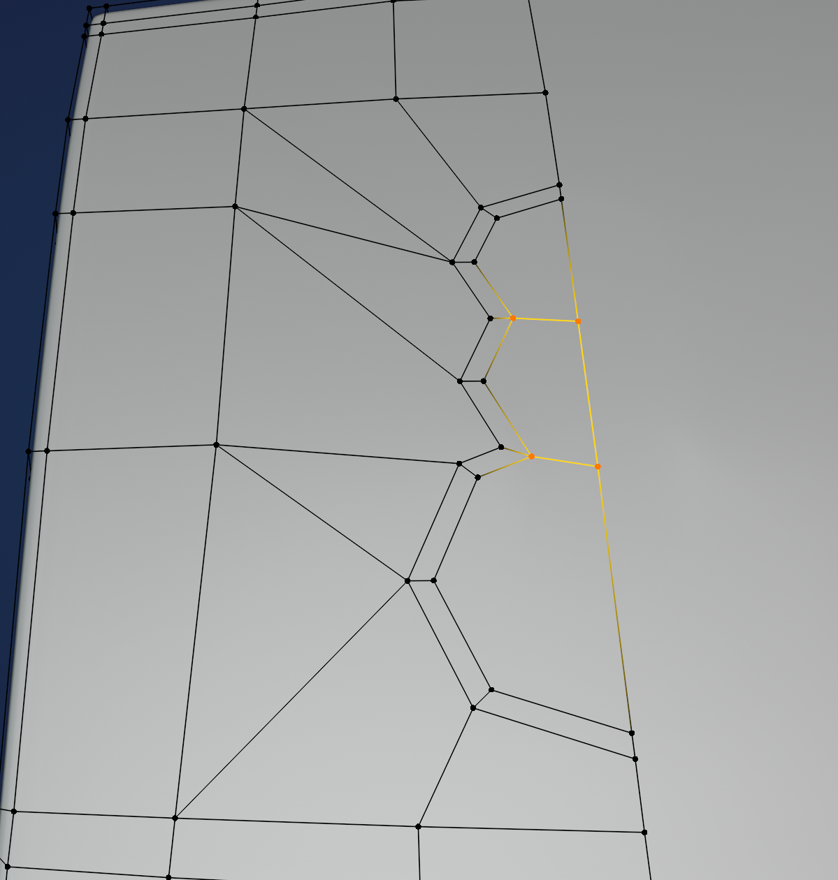

    The easiest ‘solution’ I can think of at this moment (almost midnight here, so I might not be very fit anymore😉) is something like this:
    (The more ‘Quaded’ the Topology is, the better the result.)
