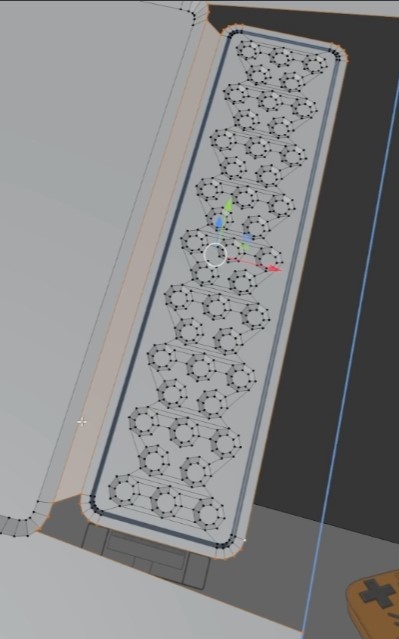

    I see now, it’s just that there is no hole in your mesh and the speaker doesn’t go above the surface, so the speaker is just intersecting with a huge face that it’s on the way. Later in the lesson JL deletes the face, leaves a hole and merges the speaker with the surrounding geometry.
