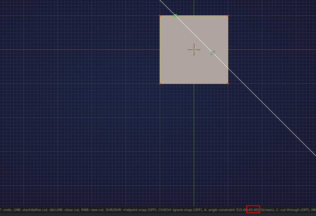

    Hi Enviritas,
    The Knife Tool is mostly used as a free-hand tool, but if you press A while making a cut with the Knife Tool, you are Constraining it to an Angle. By default this snaps to 30° increments, but a (secret) lesser known feature is, that you can change the increments by typing a number, for instance A, 45 gives:
    Knife.png.
