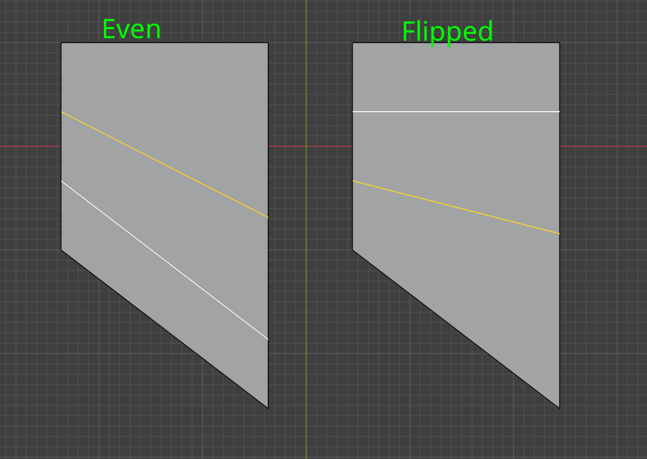

    Hi Al @aligman ,
    You are absolutely correct. It evens the bottom Edge Loop to the bottom , or (when Flipping) the top Edge Loop to the top. So:
    You can Scale the one that is not horizontal, in Z to 0, but this doesn’t happen automatically.
    I don’t know if or when Jonathan fixes that (in this case it is not important), because I still haven’t seen this new Course yet.
