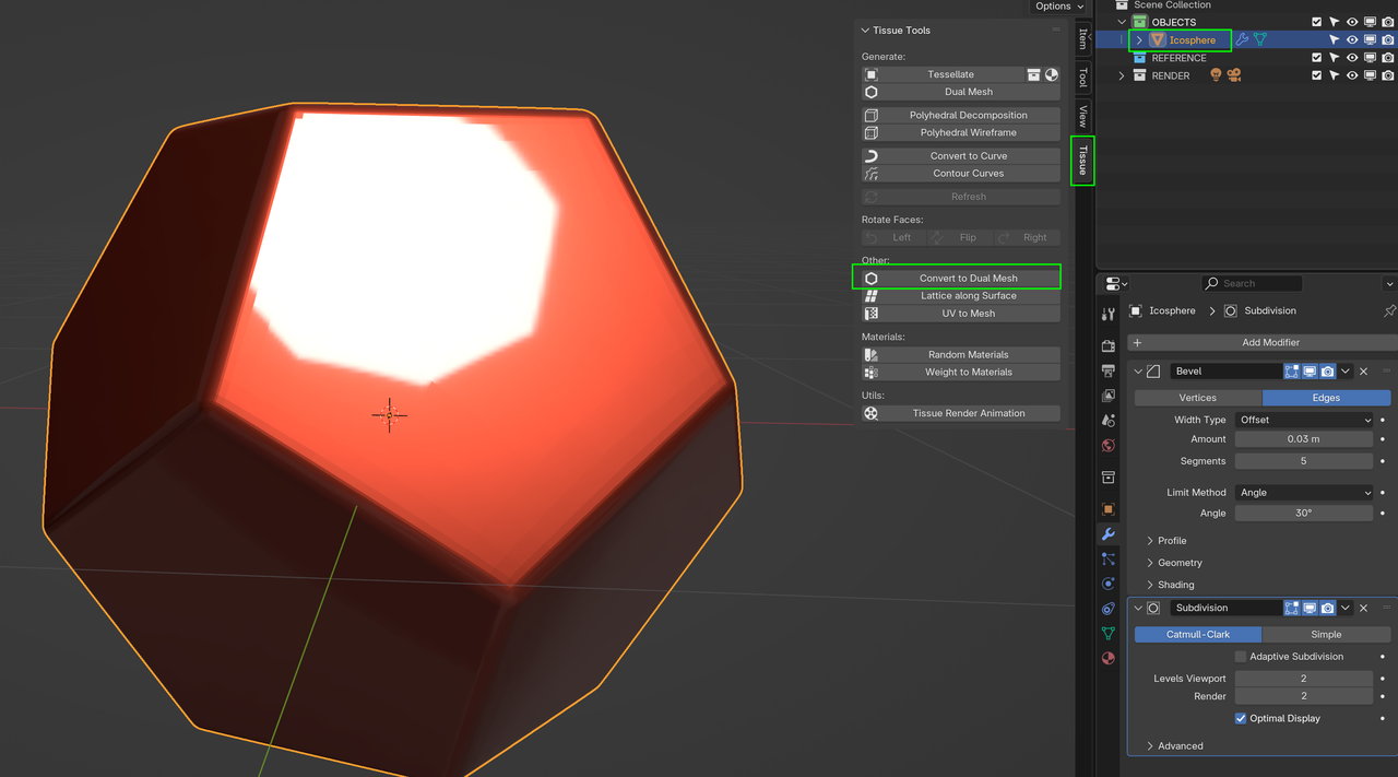

If you install the Tissue Addon, you can get a very decent result (from an Icosphere or Level 1).
This is with Flat Shading:
Set this to Shade Smooth and the result will be close to perfect.
(And Geometry Nodes also has a Dual Mesh Node.)
