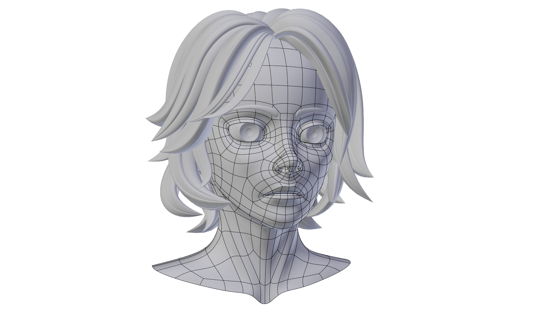

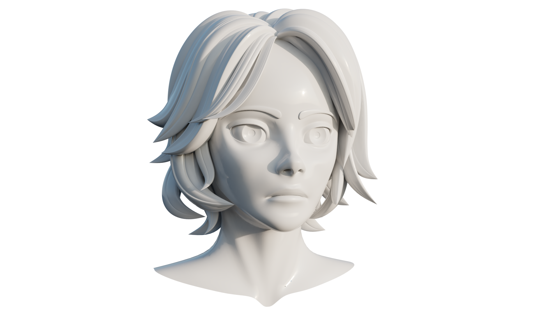

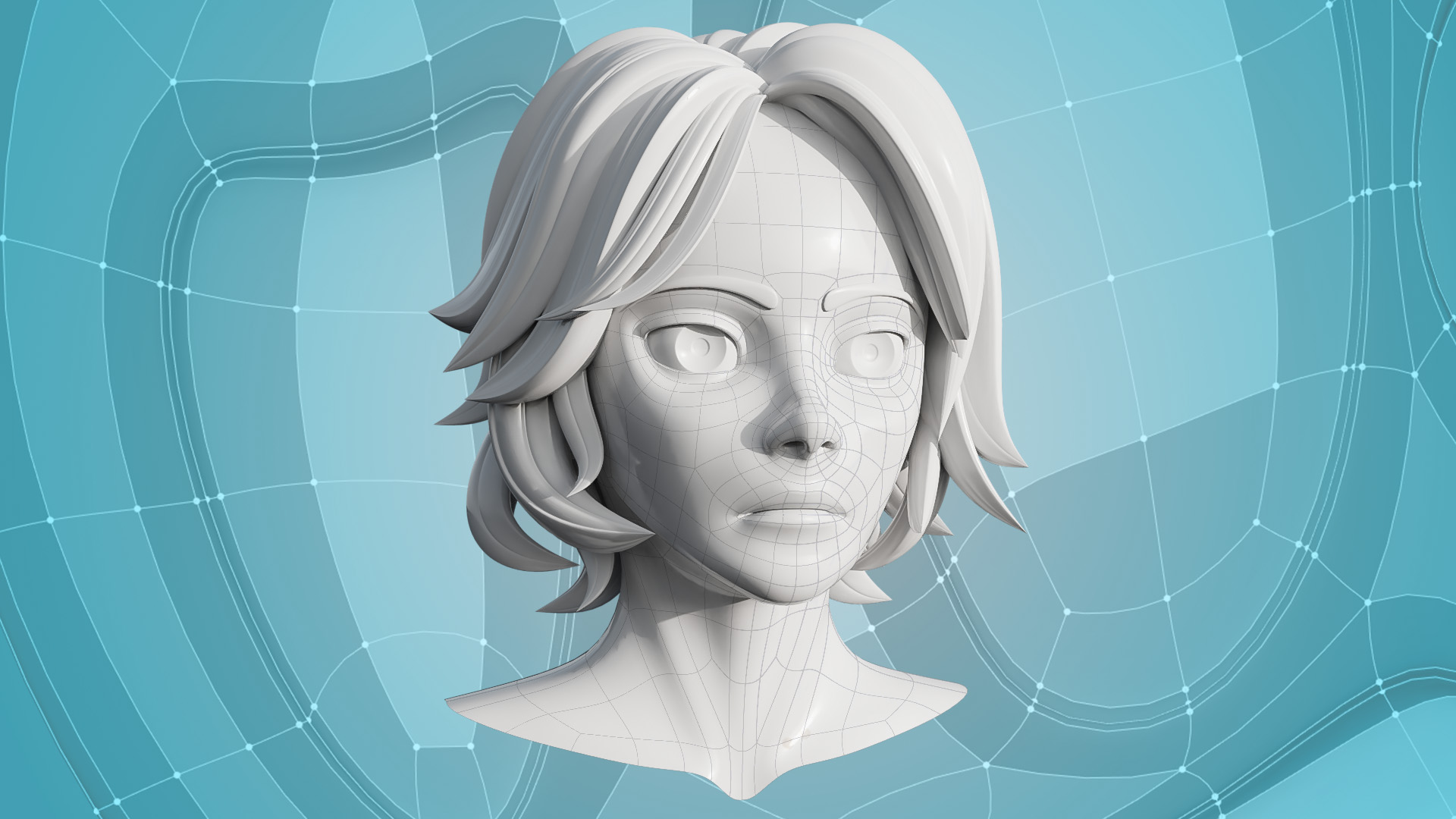

    Thanks Arun, it’s actually a pretty involved process to get that particular look. First I’ll render normally with cycles without any wires, and then I’ll do an OpenGL render with wires and then composite the two together in Photoshop. Here’s an example:
