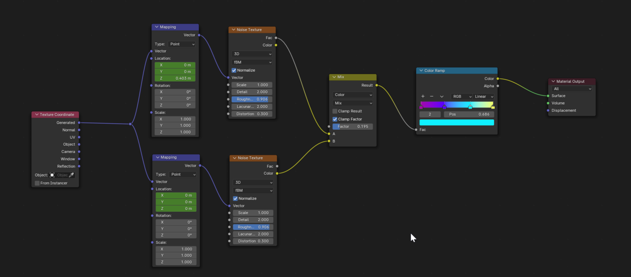

    Hi Daniel, I had the same issue. Discovered the problem was that I’d used the ‘Fac’ output on one noise texture node, and the ‘Colour’ output on the other. Hope this helps (six months later 🙃).
    e.g. the below is incorrect, both noise texture nodes should be connected via their ‘Fac’ outputs.
