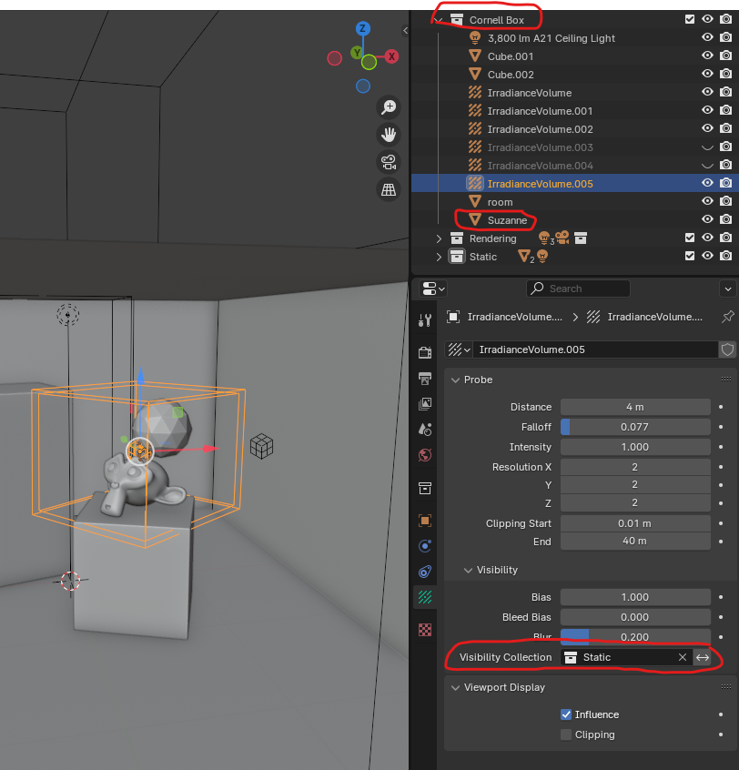

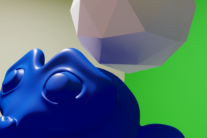

    Your Suzanne mesh is inside the Cornell Box collection, but you have the Visibility Collection set to the Static Collection, so that collection is the only one getting the influence, therefore Suzanne is not getting any influence because it’s in the wrong collection.
    If you either move the Suzanne to the Static Collection or just remove the Static Collection from the Visibility Collection options, it then works.
