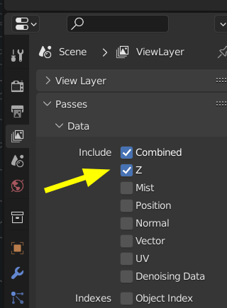

    Hi, it’s not the Normalize Node that isn’t woring, but the Depth Pass!
    The Z Pass is no longer enabled by default!
    Or maybe you  saved your render as a PNG. That doesn”t save the Depth information.

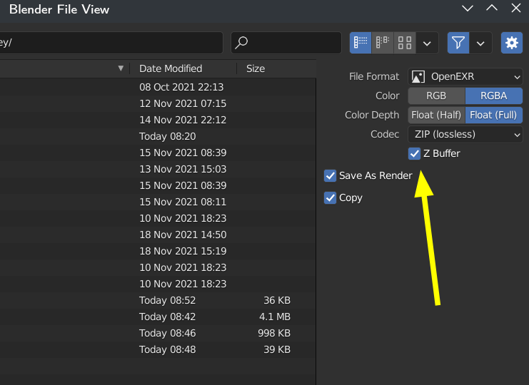

    You should have used EXR with Z buffer enabled:
    Or EXR Multilayer.
