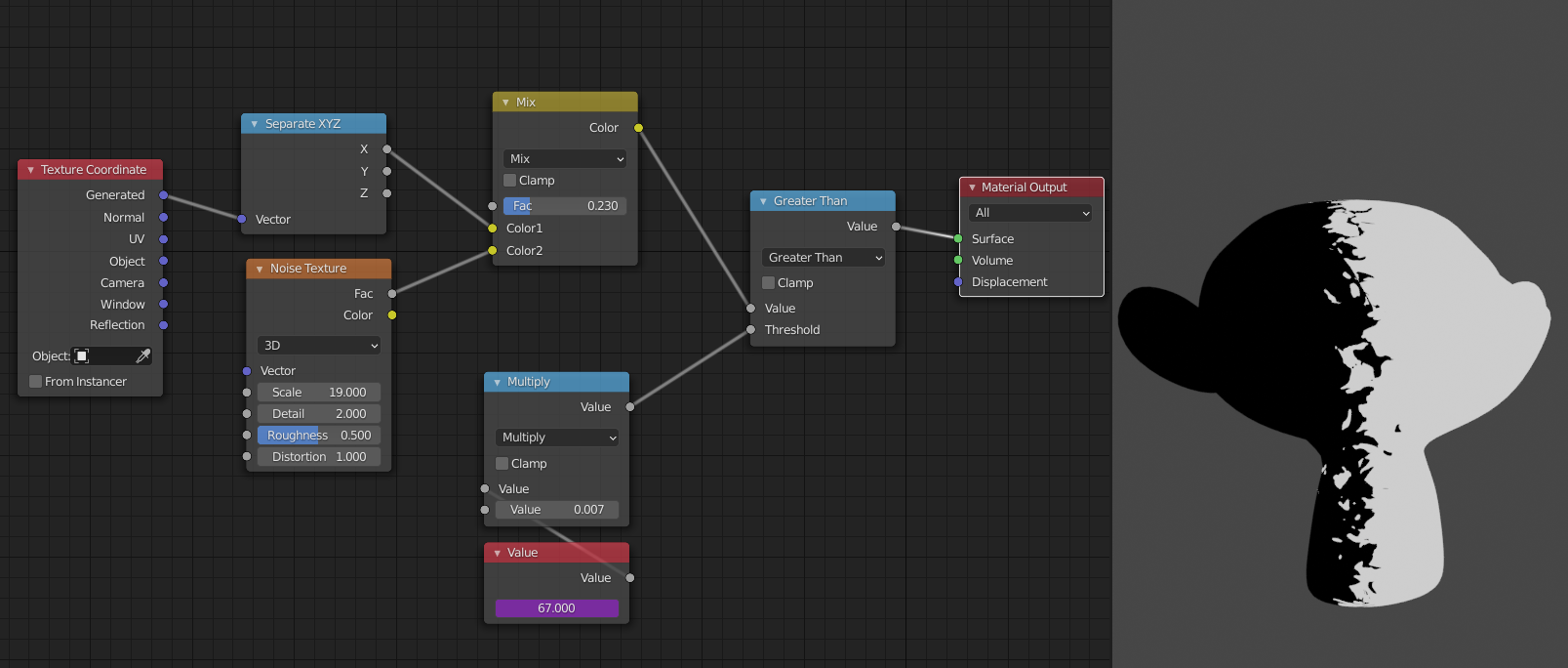

    As to your question above: you can achieve a similar effect with a 3D Noise Texture in various ways. I would probably do something based on this:
    Is that what you meant?
