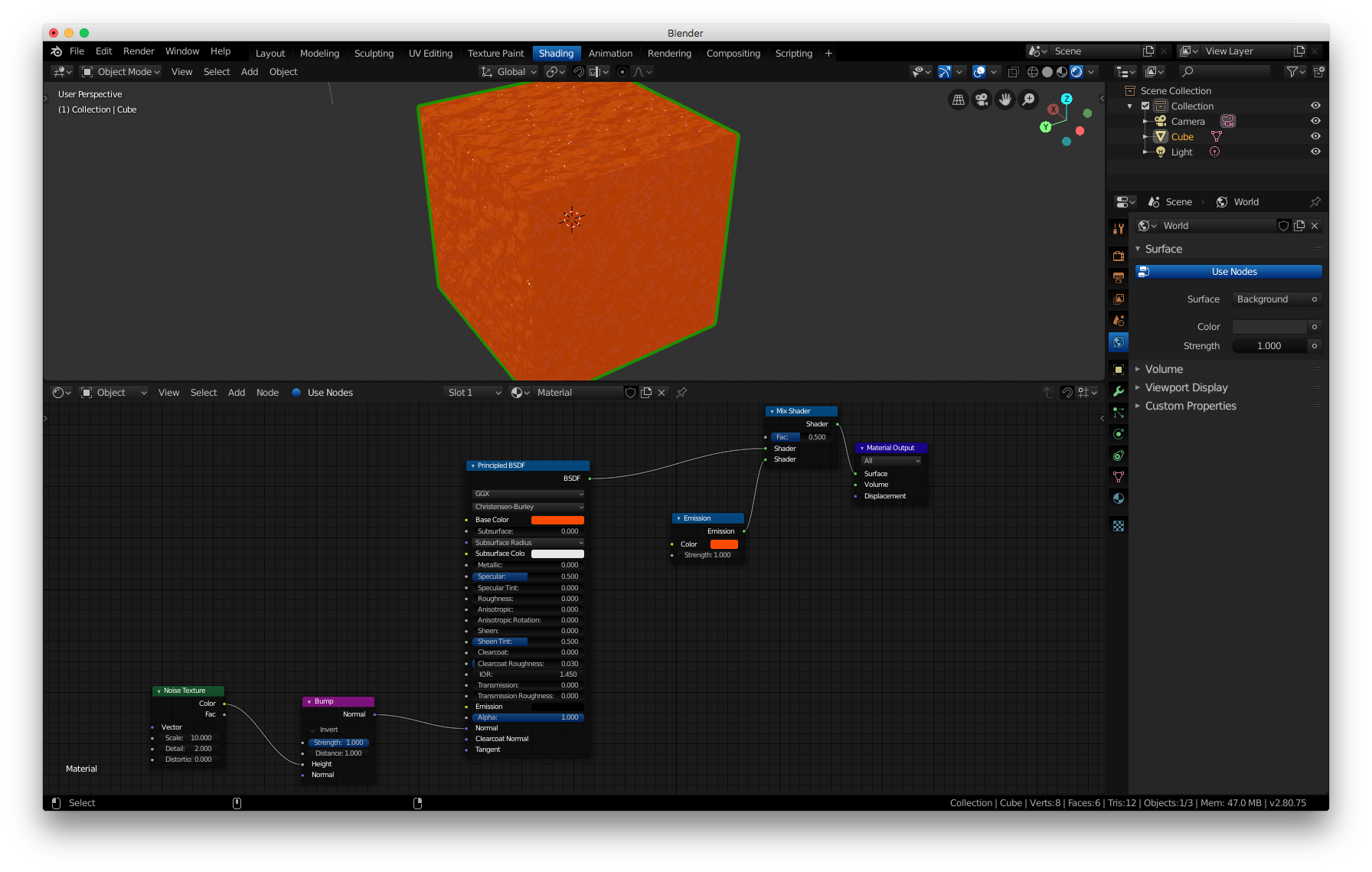

    @cruento I just thought I would take a stab at it.
    I saw somewhere that mixing in an emission color node helps maintain the color regardless of the lighting. I just made a simple shader graph mixing the principled bsfd and left the light white.
    When I only use the emissions I won’t get shadow data and the object will look more like a silhouette. I added a noise texture to just show that having that principled bsdf does help change the shading on the bumpy surface.
    One extra thing to note: The world color space is also affecting the color (shown in the world menu on the right). I have mine set to a darker gray, but this is where an HDRI map may help you select the correct environment.
    I hope this may possibly help. Let me know.
