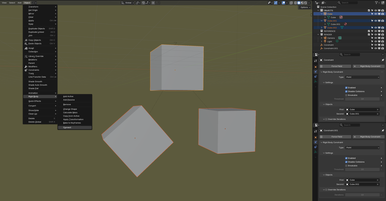

    But there is a fast way to Add a Constraint between Rigid Bodies, that you can also use for more than 2 Objects (will prodsuce more than 1 Constraint):
    From the Object Menu:
    It will automatically Add the Empties which hold the Constraints and you can change the Constraint Type in the “Adjust Last Operations’ pop up (or F9).
