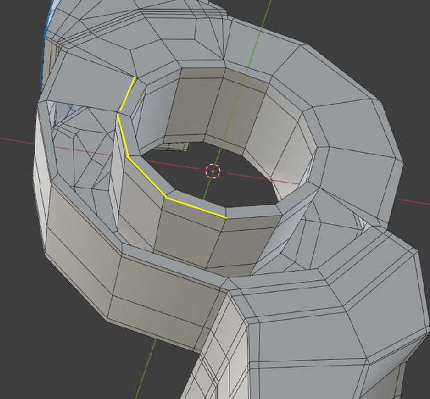

Hi Charles @thehomme ,
Omar is right, you have so-called interior Faces:
These Edges all around, are connected to 3 Faces:
