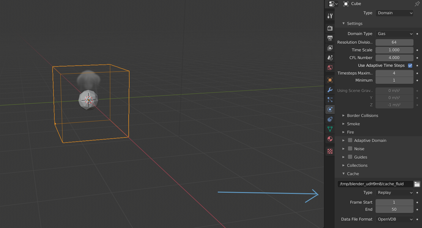

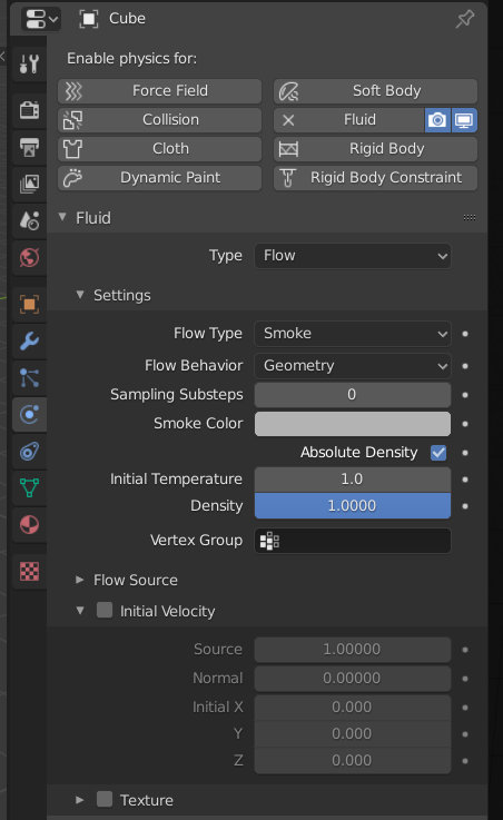

    Hi randyroth Blender now uses Mantaflow for smoke simulations and it is now hidden under Fluid.
    Set the Type to Flow and then the Flow Type can be set to Smoke.
    Also: unless you set the Domain Cache Type to Replay, you need to Bake the simulation first to be able to see anything.
