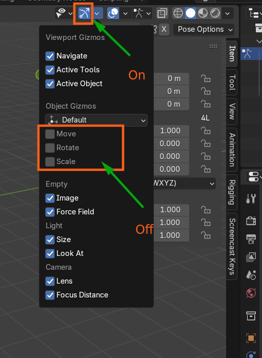

    Manipulators:

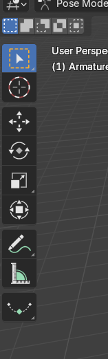

    – it could be that you have switched to a specific tool from the side panel. Try changing to the box select  tool which will allow any active gizmos to be visible at the same time.  (it’s the top one of the tool bar there)
    -Make sure you have the manipulators enabled but the gizmo overrides off.  (this is the most flexible way to use the maniputors imo)
