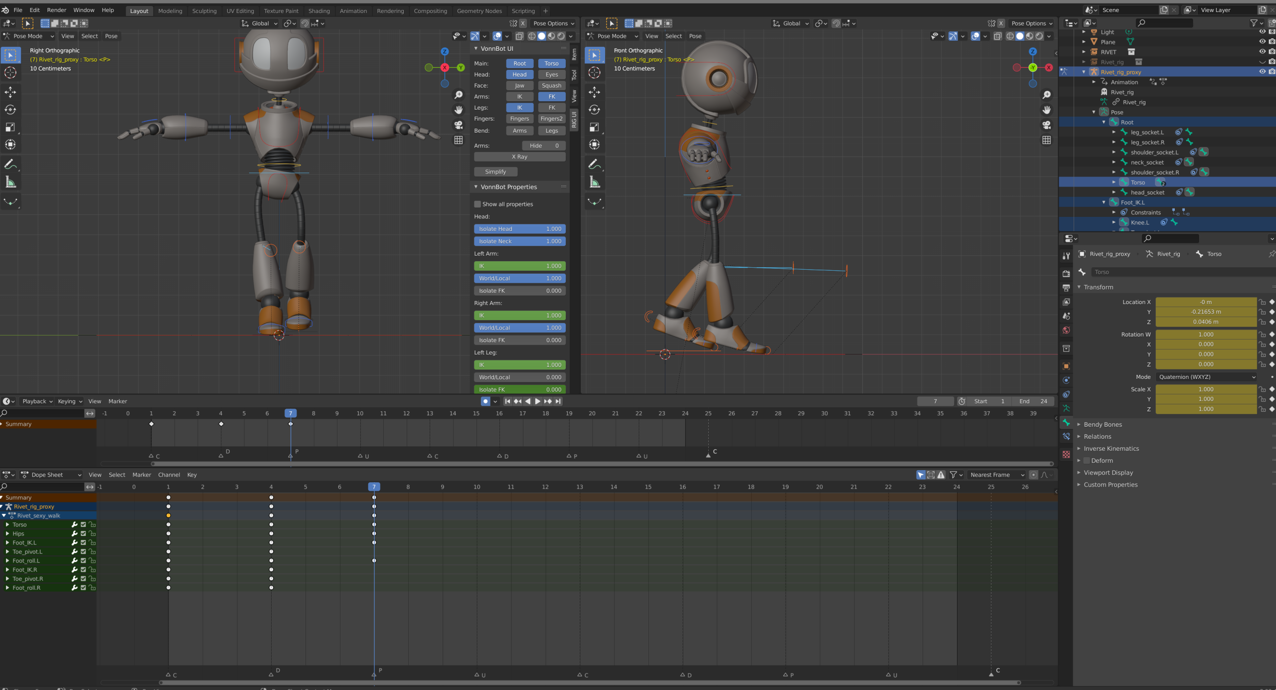

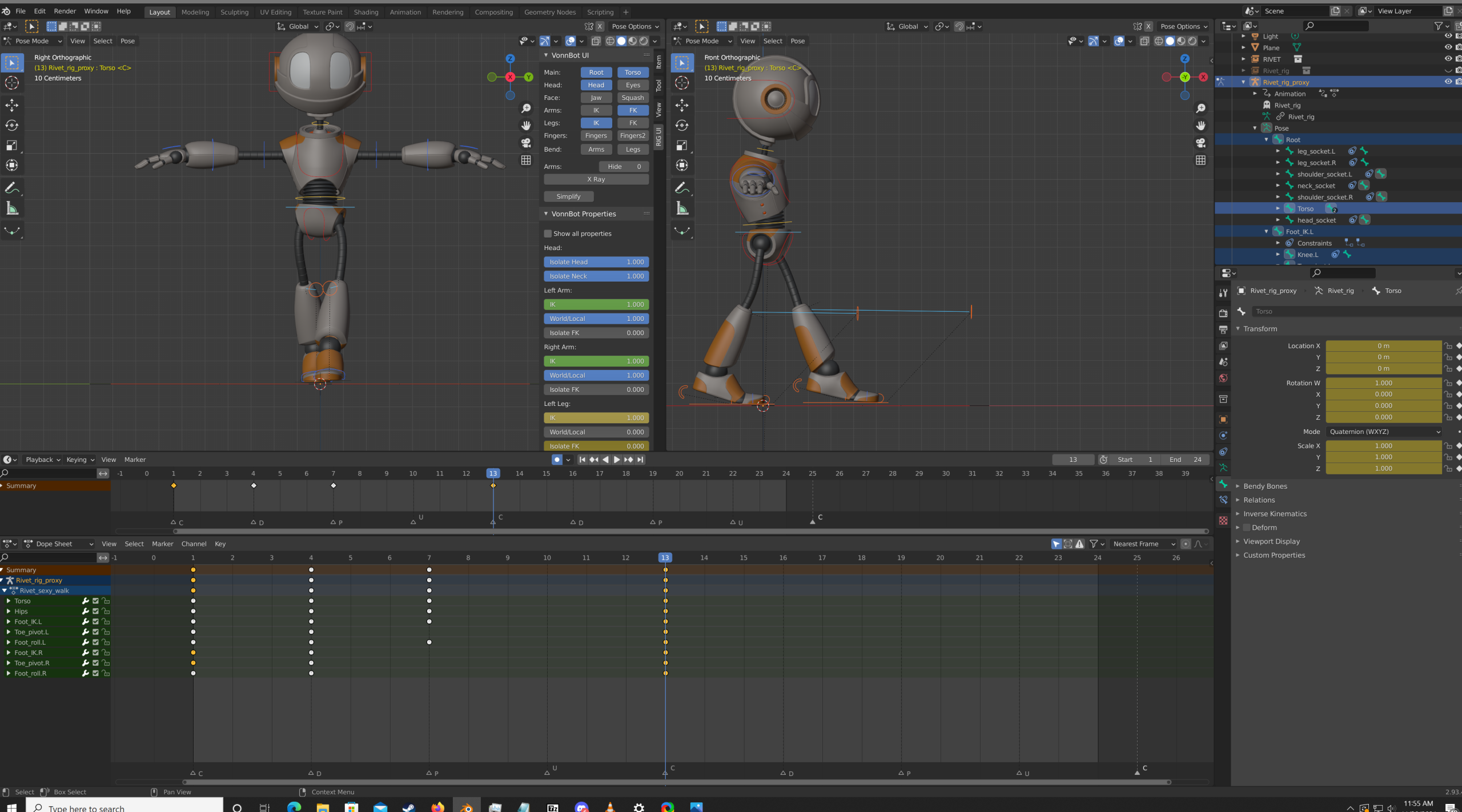

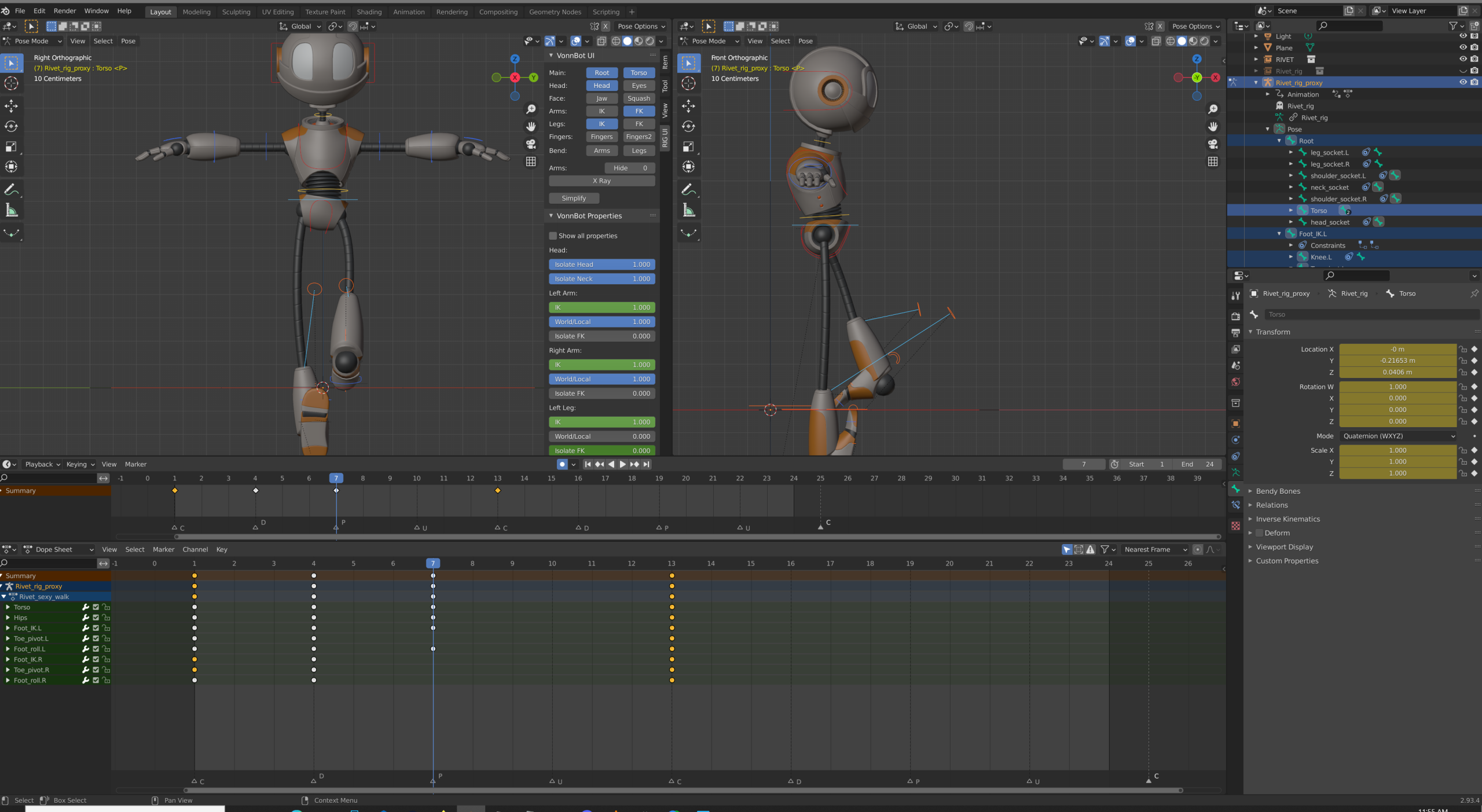

    Welp, this caused a new problem. I’m including it in this thread because it seems related. So in the first image, I’ve got the first three poses for Rivet’s sexy walk — the first C, D, P. The playhead is on frame 7 (P) so you can see what it looks like before I add a mirrored C pose on frame 13. (Weird toe walking, but otherwise normal, and how I want it to look.) In the next image I went ahead and mirror copied the C pose from frame 1 to frame 13, which looks like it works just fine. But the third image shows what happens when I scrub back to frame 7 — for some reason, that pose (and in fact everything starting at frame 6) is now all kinds of wonky. This only happens after I mirror copy the C pose on frame 13, and it happened in a previous version when I had all four poses blocked out, so it’s not about adding in the U pose.
    Any ideas?
