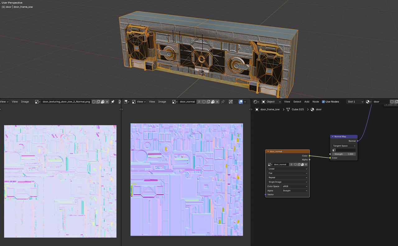

I don’t know exactly what’s happening, but it seems to me, that it’s not simply the Mirror Modifier, that’s causing it, but the compression from 32 bit EXR to 8 bit PNG.
Also the change from sRGB, to Non-Color makes a difference.

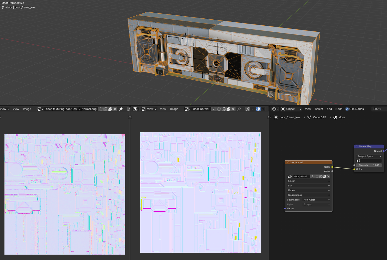

door_normal, sRGB:
door_normal, Non-Color:

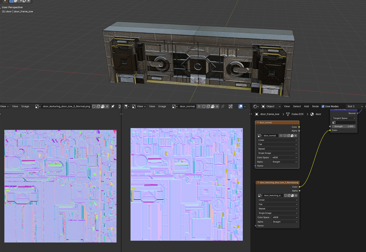

door_texturing…, sRGB. Doesn’t fix it:
I don’t have access to Substance Painter and I haven’t watched all of these Lessons, but it seems to me, that the problem occured somewhere after Importing to SP.
