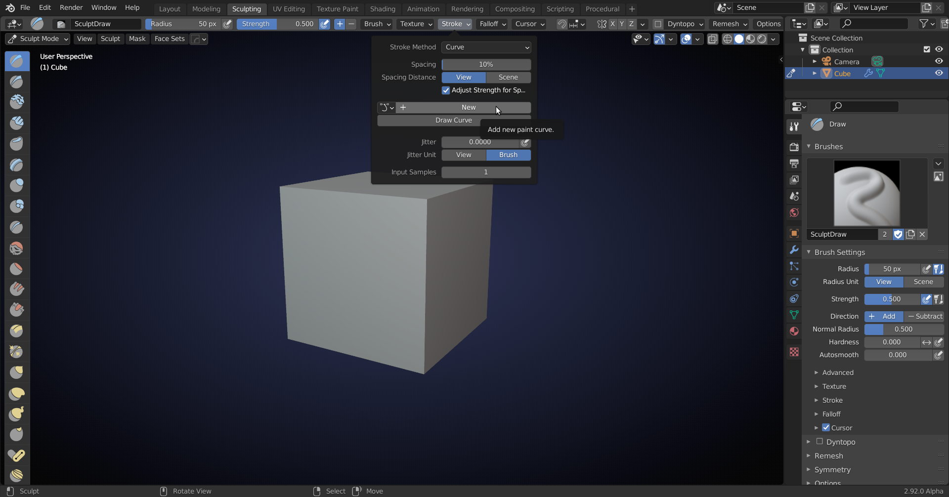

    There is another way to make smooth curves when sculpting and that is to set your Stroke Method to Curve:
    and add a new paint curve.

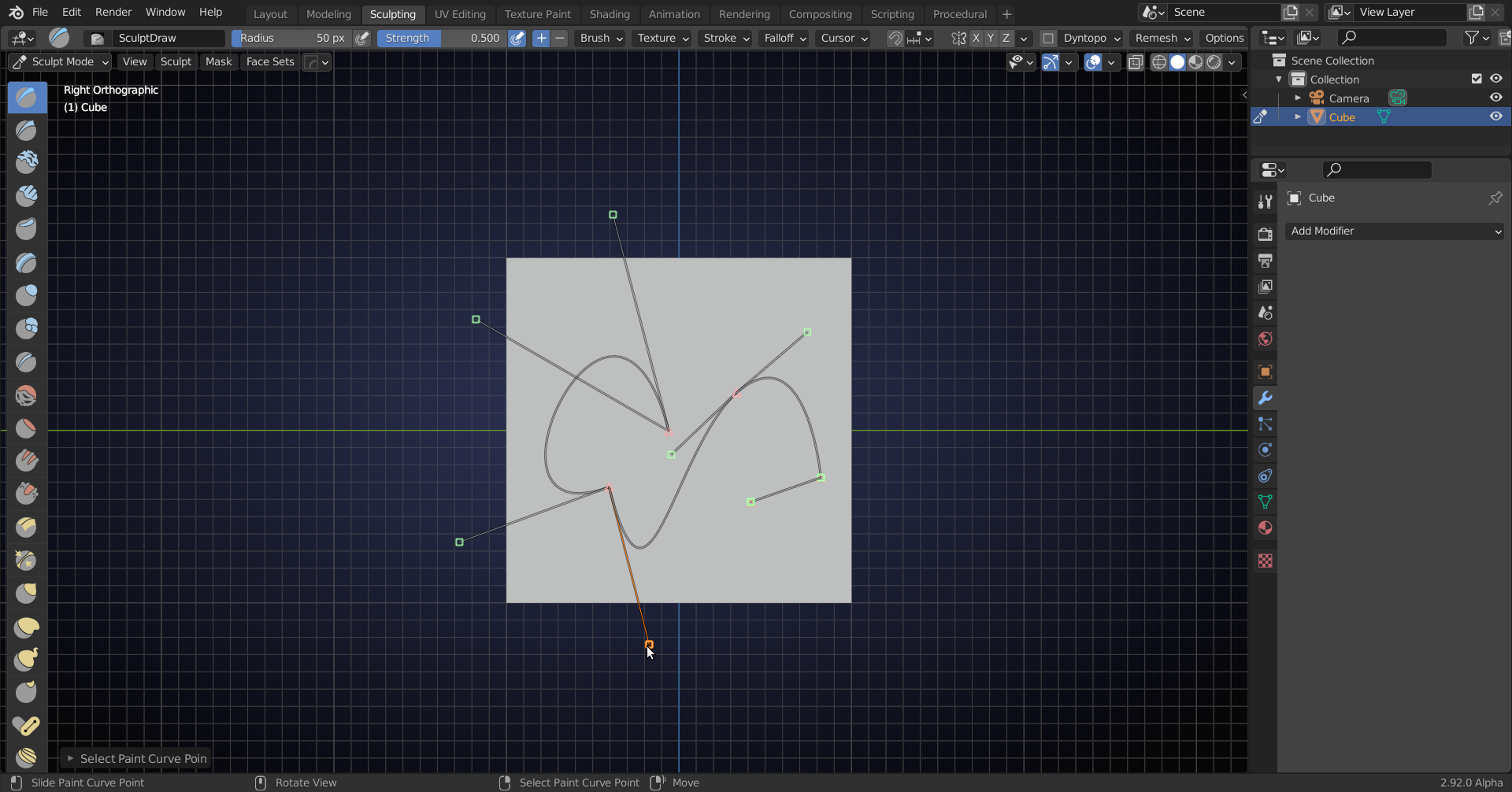

    Then you can make a curve point with CTRL clicking and with CTRL click and drag you get a point with handles. You can adjust the Curve untill you are happy with it:
     and then press enter to sculpt that curve with your selected Brush:
    Especially handy when making repeating curved ornaments.
