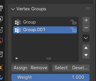

    There are a few ways to do what you need.
    The quick way is probably to weight paint (subtract) the weights from that group.
    However you can remove all the verts from a group in the Vertex group tab.
    Select you verts, then highlight the group in that tab, then hit the remove button.
    I can’t annotate with this snipping tool but hopefully you see it right next to the “assign” button.
