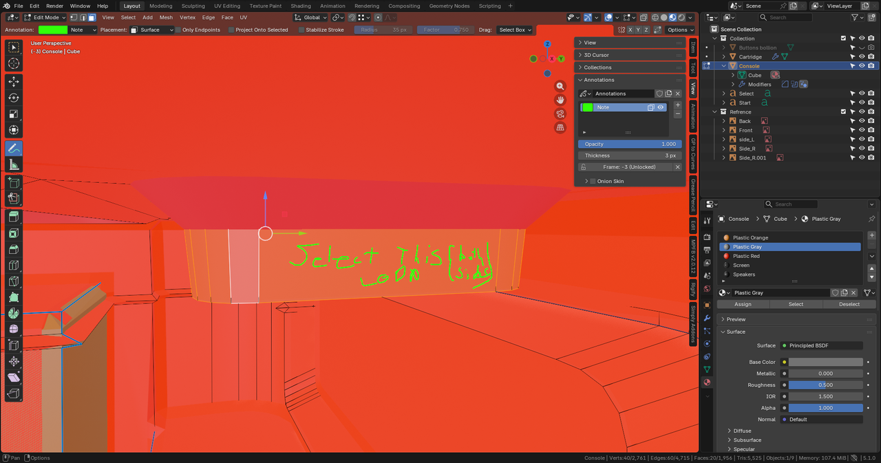

Ah! on the inset part, it’s just scaled too big. If you go into the interior and select this loop on both sides and ALT-S to scale them along the normals, that should fix it. Don’t have to scale it much, just enough to get rid of the line.
