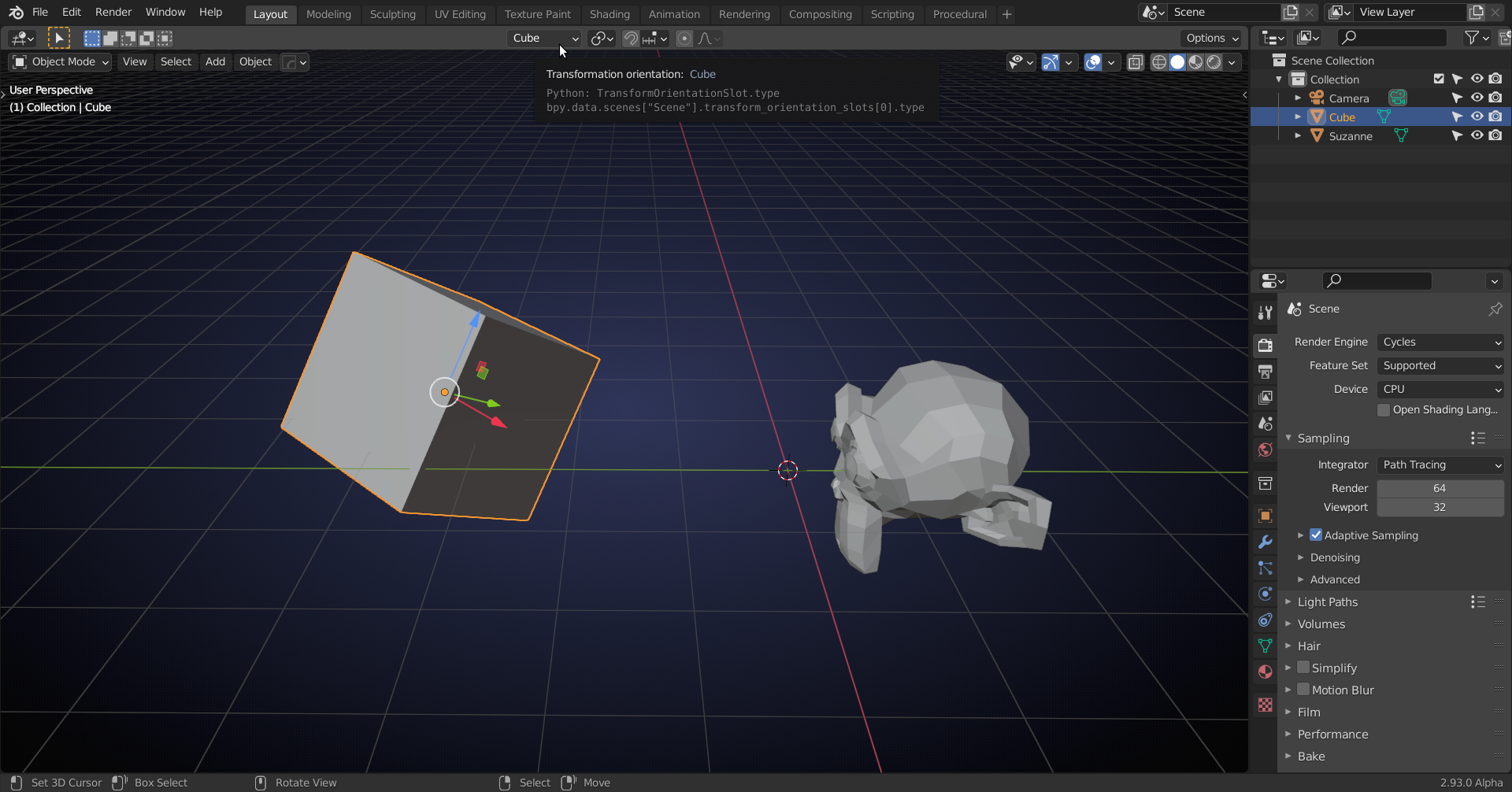

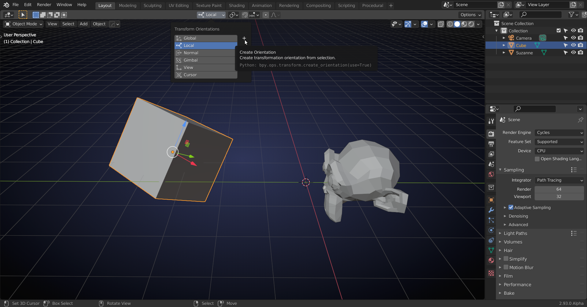

    Make a Custom Orientation with the Object that you want the Rotation matched to selected:

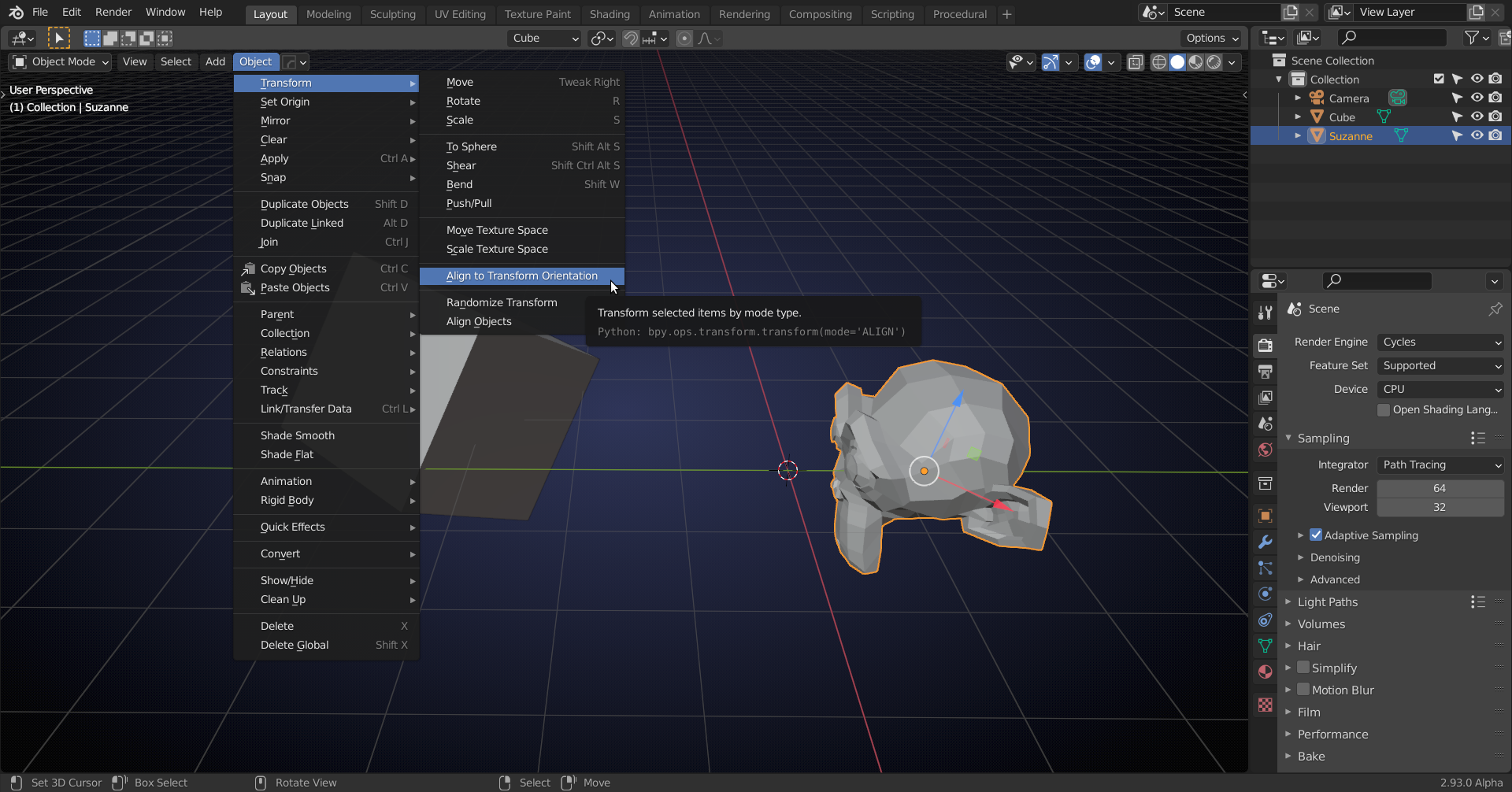

    Then select the Object that you want to match and:

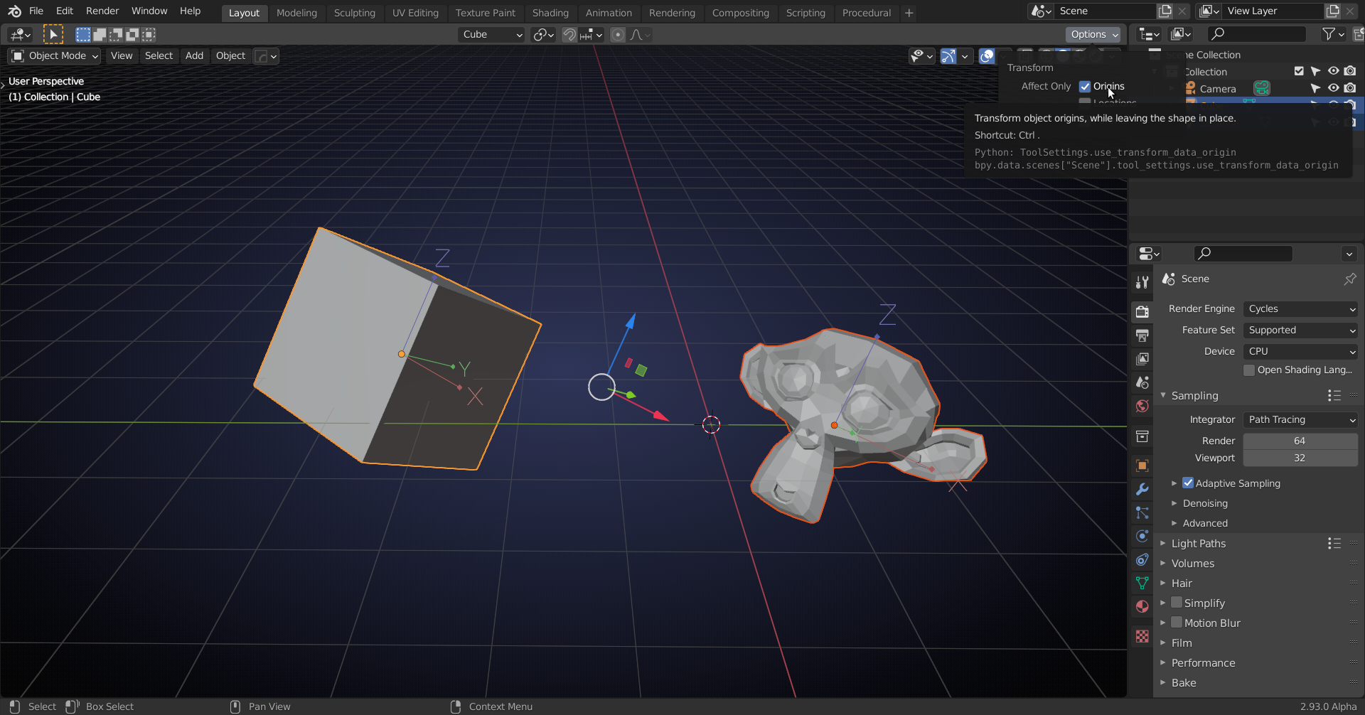

    Now, if you only want the Origin matched, use this Option:
    For the Location (whether only the Origin or the whole Object), presss CTRL+S:

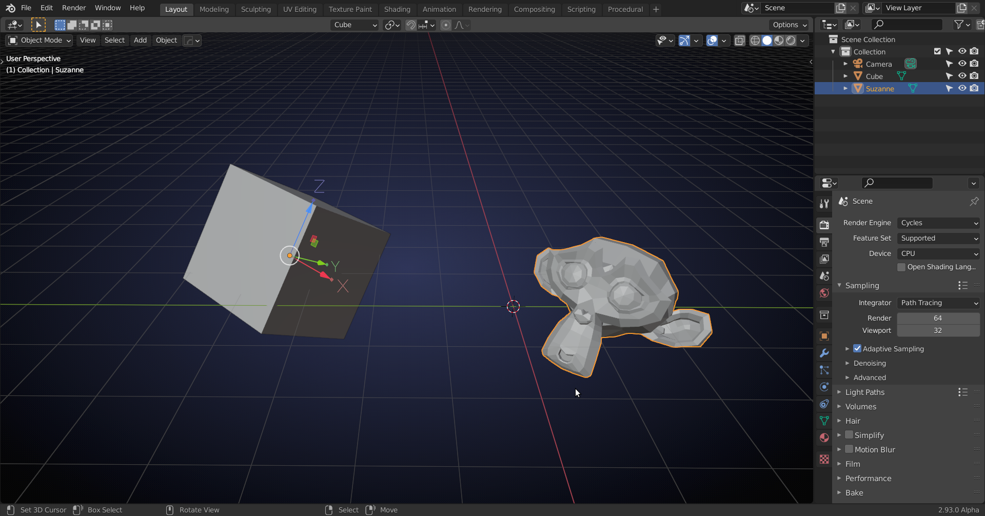

    And you get:
